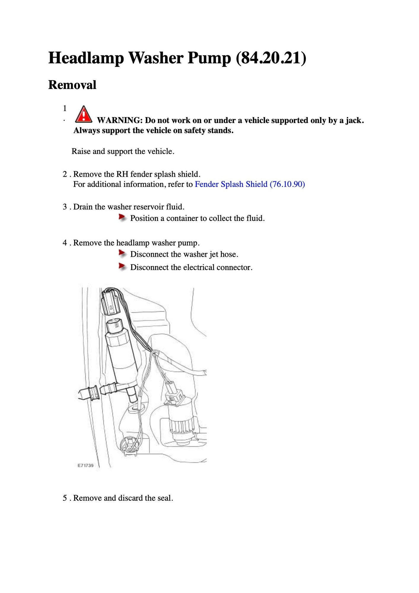

Worth a check - pump motor and or connector would be worth a look at too:
Headlamp Washer Pump Removal
Raise and support the vehicle.
Remove the RH fender splash shield.
Old Oct 2, 2024 | 12:23 PM

According to the manwell there is two pumps - one fer windshield and one fer pump power-wash fer head lights. Maybe it's a combo pump - I dunno
Old Oct 2, 2024 | 05:02 PM
McJag222's Avatar
Joined: Jul 2016
Posts: 1,447
Likes: 852
From: Vancouver BC
Dere be two pumps
Screen wash pump C2S4065
Headlamp power wash pump C2S4086
