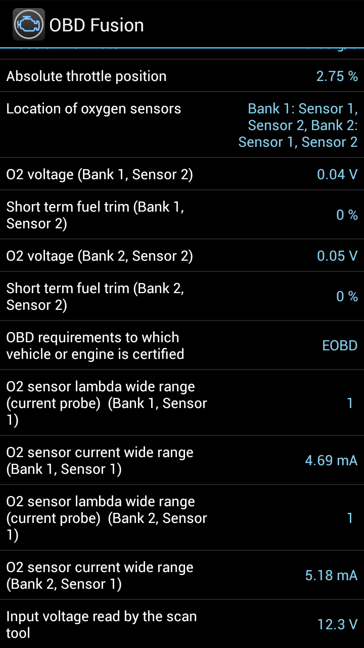

Here are the OBD Fusion SAE PIDs that work with my o2 sensors.
For the upstream o2 sensors...
o2 sensor lambda wide range(current probe) (bank 1, sensor 1)
o2 sensor lambda wide range(current probe) (bank 2, sensor 1)
For the downstream o2 sensors...
o2 voltage (bank 1, sensor 2)
o2 voltage (bank 2, sensor 2)
When creating your dashboard for your o2 sensors, scroll down the sae pids until you find the above pids and select...
hope this helps.

Its not the rear o2 (downstream o2) thats reading 0v
its one of his upstream o2,s (o2 sensor 1 is an upstream sensor)
It would be nice to see the LTFT,s for bank 2 with engine up to temp in park at 650rpm and also at 2500rpm,
The same for bank 1 even though the is no coad for bank 1................................................. ..............................

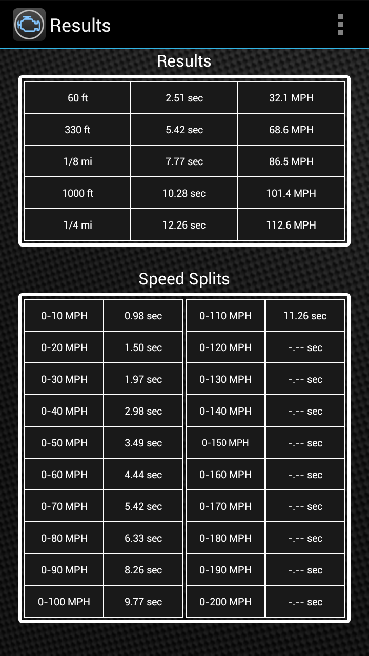

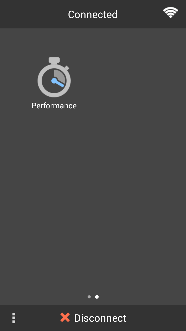

Default Hope this helps.
Just to show you what you can see with obd fusion ....

NO Fusion wont fix the problem.......
But some useful information on the data you can get from Fusion might help point in the direction that may help fix the problem.(or not)
Also put some fun stuff in there to show the app isnt just for diagnostics.
I suppose instead of trying to help some one understand what there app is capable of, and how dashboards should be set, I could just sit back and do NOTHING.
