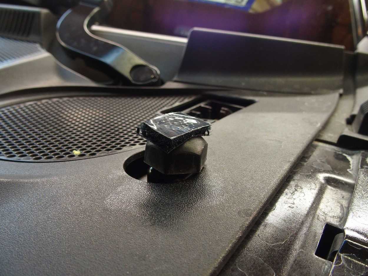

I have a dash rattle which I think might be the hood bounce (I'm hoping). I tried simply turning the pads to raise or lower them but they don't seem to want to move, being afraid of breaking old plastic I'm looking for advice from someone that has actually raised or lowered these stops. I'm afraid the top pad with the flats zd will break off of the threaded section

thanks CeeJay, I found I could bounce the hood a tiny bit, so there is clearance. I sprayed the threads with wd40, still too tight for me to try twisting. I placed a small square of industrial male+female velcro on them which removed the clearance... we'll see if that is actually the rattle.

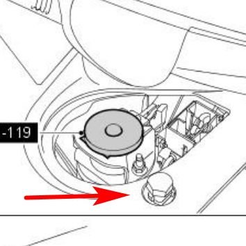

My 2008 does not have pedestrian safety stuff. ..the arrow points to what I need to adjust up a bit.

For those that missed my comment @ using a bit of felcro, you can see that the left side is compressed a bit and the right hardly at all...indicating that there is a little bit of free play.

there are further adjustments on the underside of the hood ie the bonnet locking mechanism both sides can be adjusted to either loosen or tighten
Reply 1
Dec 4, 2025 | 06:03 PM
Quote: there are further adjustments on the underside of the hood ie the bonnet locking mechanism both sides can be adjusted to either loosen or tighten
@wymjym By George I think he’s right.For the passenger side at least.
Just took off the cover panel and lifted up the windscreen fluid cover (just lifts, small non locking tab).
Can’t get the camera in there, but there is a nut underneath.
Driver’s side you’ll have to go in from the wheel well.
Bit more of a pain.
