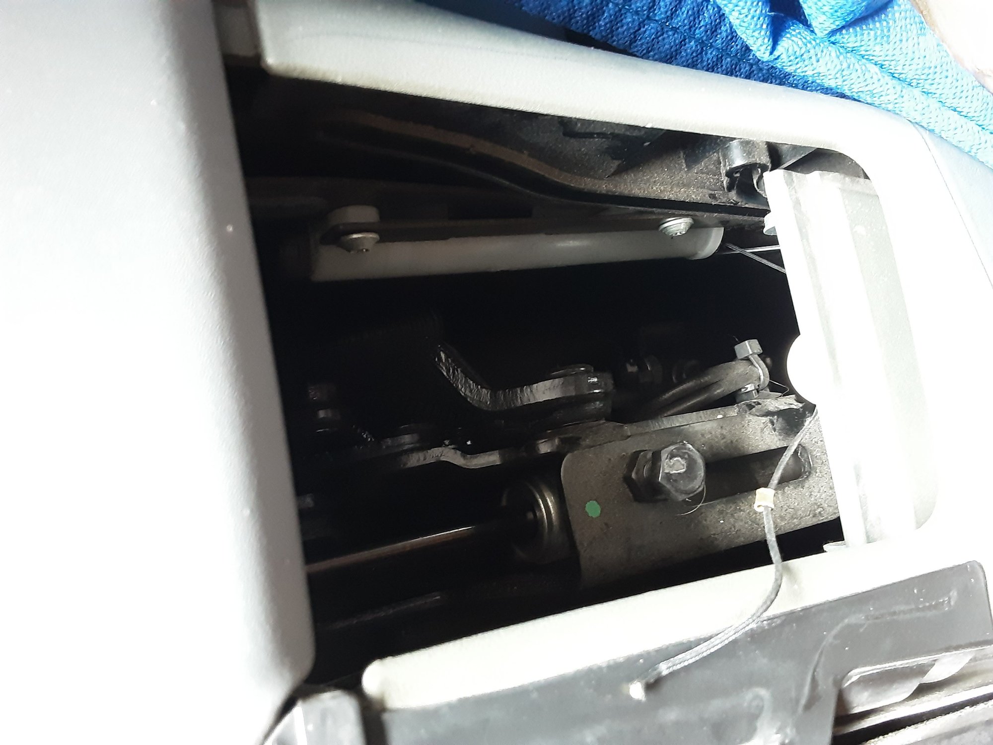

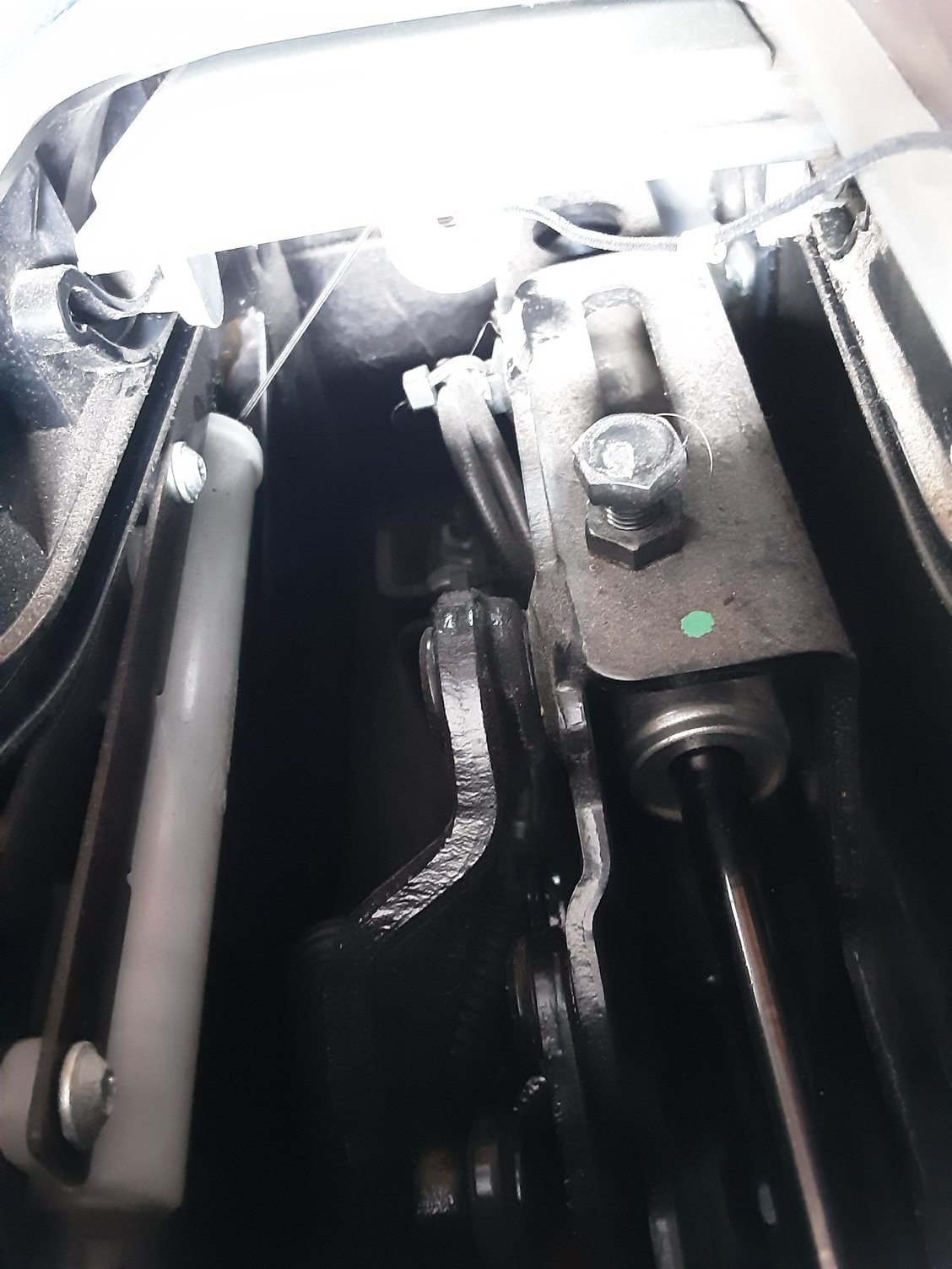

Before I attempt my situation I have a few questions. 1. I can see my flap down in the slot also a wire. I will attach a picture or two. 2. Should I be able to move my flap readily becauseitdoesnot move freely and appears notin track. 3. Do I try to move my flap until it freely moves. 4, this wire I see is not the same as yours? 5. My top still works ...can I stop it part way?
Old Mar 17, 2026 | 04:17 PM
wymjym's Avatar
Joined: Oct 2016
Posts: 1,766
Likes: 1,241
From: near Austin
you need to take a couple more photos, maybe without the flash since that is washing out some details.
point your phone in the direction of the arrow and upload those, there is little bunk where a cable needs to wrap around. Then we can direct you better.
