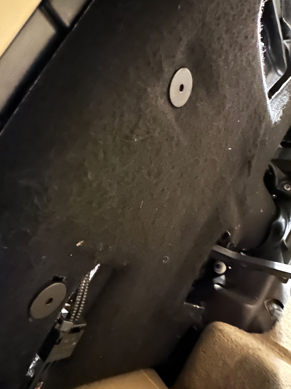

Anyone know how to remove this? Give it a good tug? Any screws to remove? Trying to replace my accelerator pedal

Good tug.

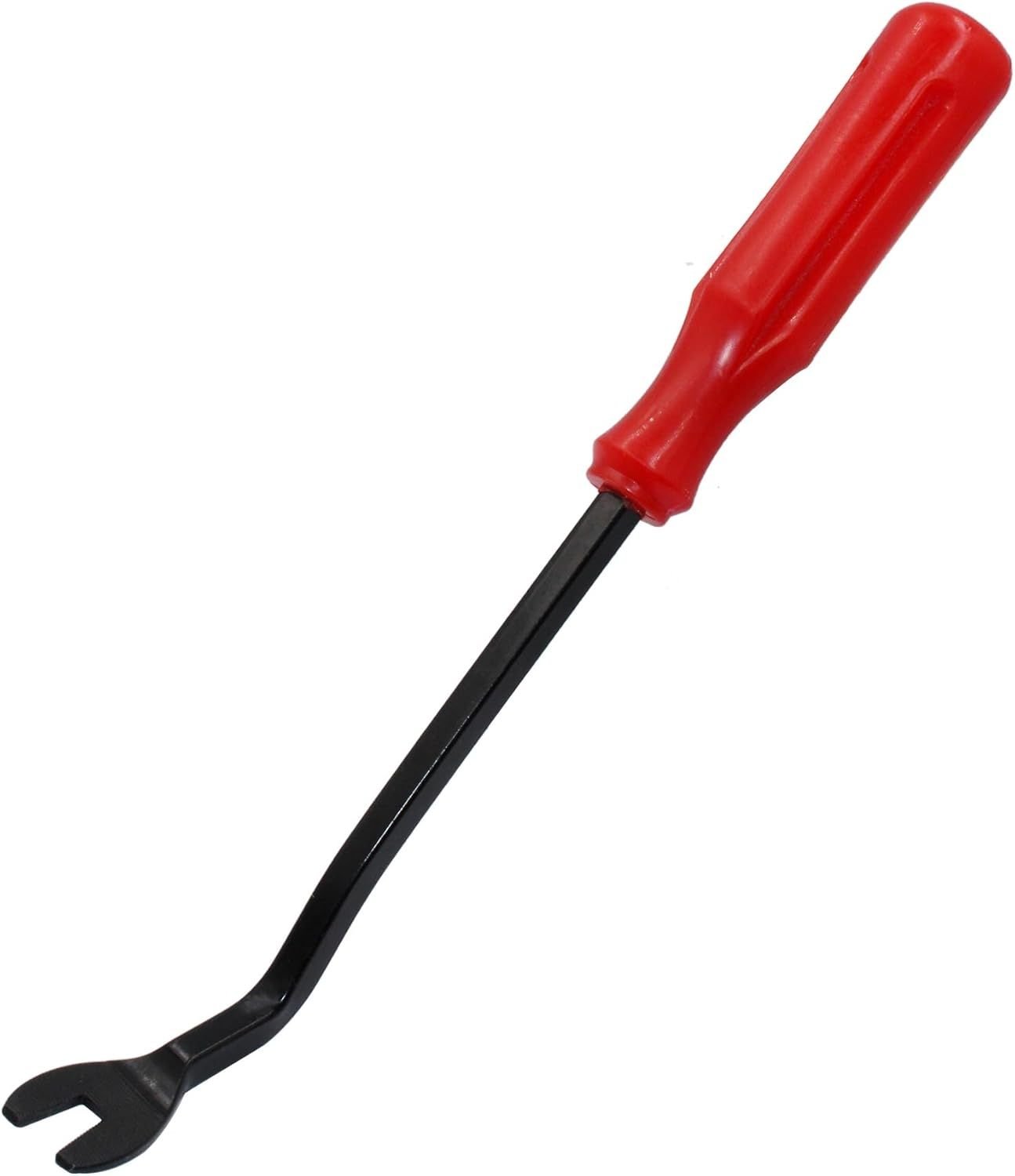

One of these

Closing the loop for someone in the future. You just have to jam in a tool into the 3 clips and force them out. Takes lots of force. I replaced them with easier fender clips.
