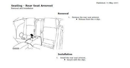

Here's the relevant sections from the Workshop Manual:
Old Sep 9, 2021 | 04:25 AM
Forgot the section for the Armrest:
Old Sep 9, 2021 | 08:11 AM
