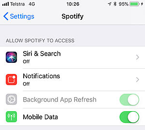

Well this sucks, it's greyed out, can't turn it off.
Looks like I'll be uninstalling then, I only use Spotify for demonstrating the InControl Apps in other cars, not in my own.

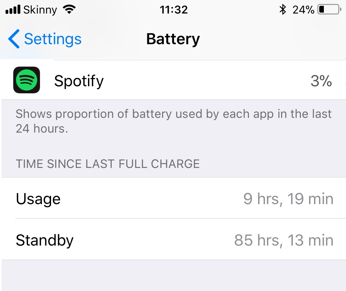

If Spotify is the culprit on the iPhone then it should appear in the battery usage list in the settings menu. I have been listening to my exhaust more rather than music recently and Spotify only claims to have used 3% of the battery since the last charge.
Even when I was using Spotify heavily in the car I could still go up to 5 days between charges on my iPhone 6+. The battery isn't so large in my 8+ but I still manage around 4 days.
