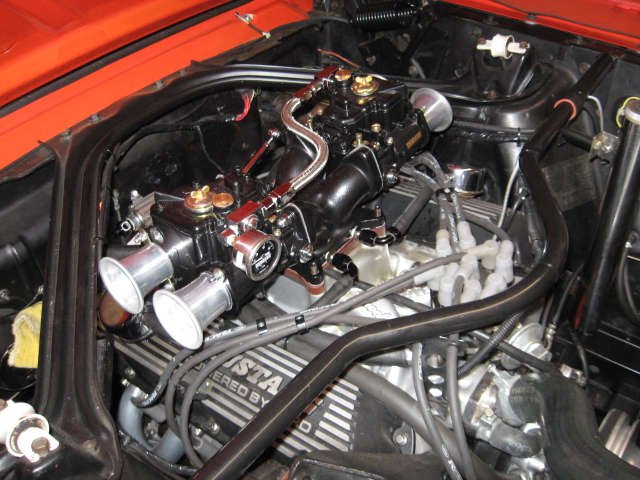

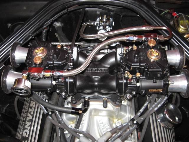

Yeah, I'd like to see the A/F curve, as well. All of my performance tuning has been with modifications made to my 289/331 mustang engine and it's normally aspirated WEBER carbs. I'm "green" to EFI systems.
Attached Thumbnails Just came back from the dyno-dressed-black-2012.jpg   Just came back from the dyno-engine-w_webers.jpg
