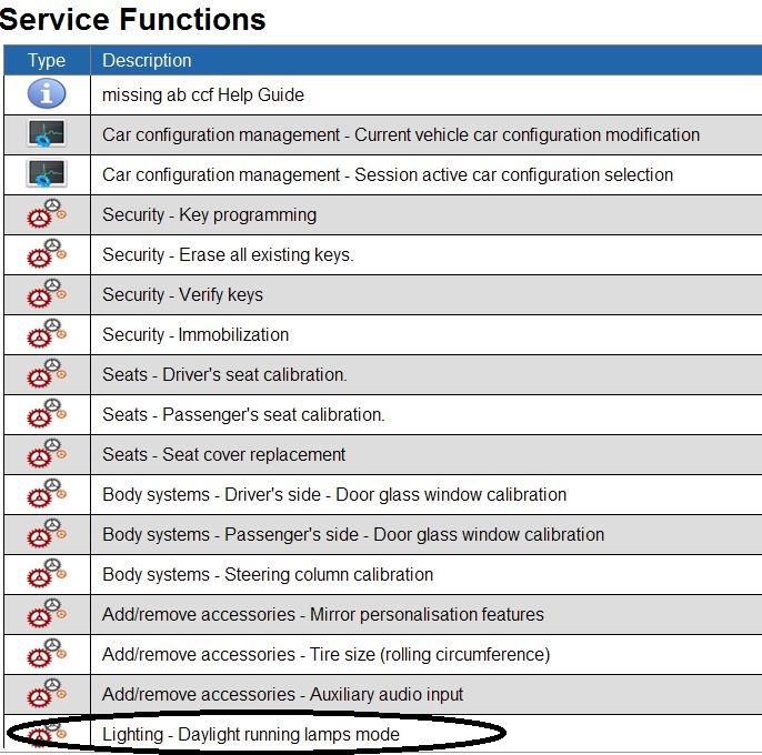

If you have access to a Mongoose or similar device you can probably turn it on in the programmable car options.
This is a screen shot from SDD plugged in to my '07 XKR.

I went to my dealer and asked them to activate the DRLs on 2012 XK at its first service. They activated them by going into one of the programs and the DRLs go on when the car is put into gear and turn off when it is put into neutral or park. No charge!!
