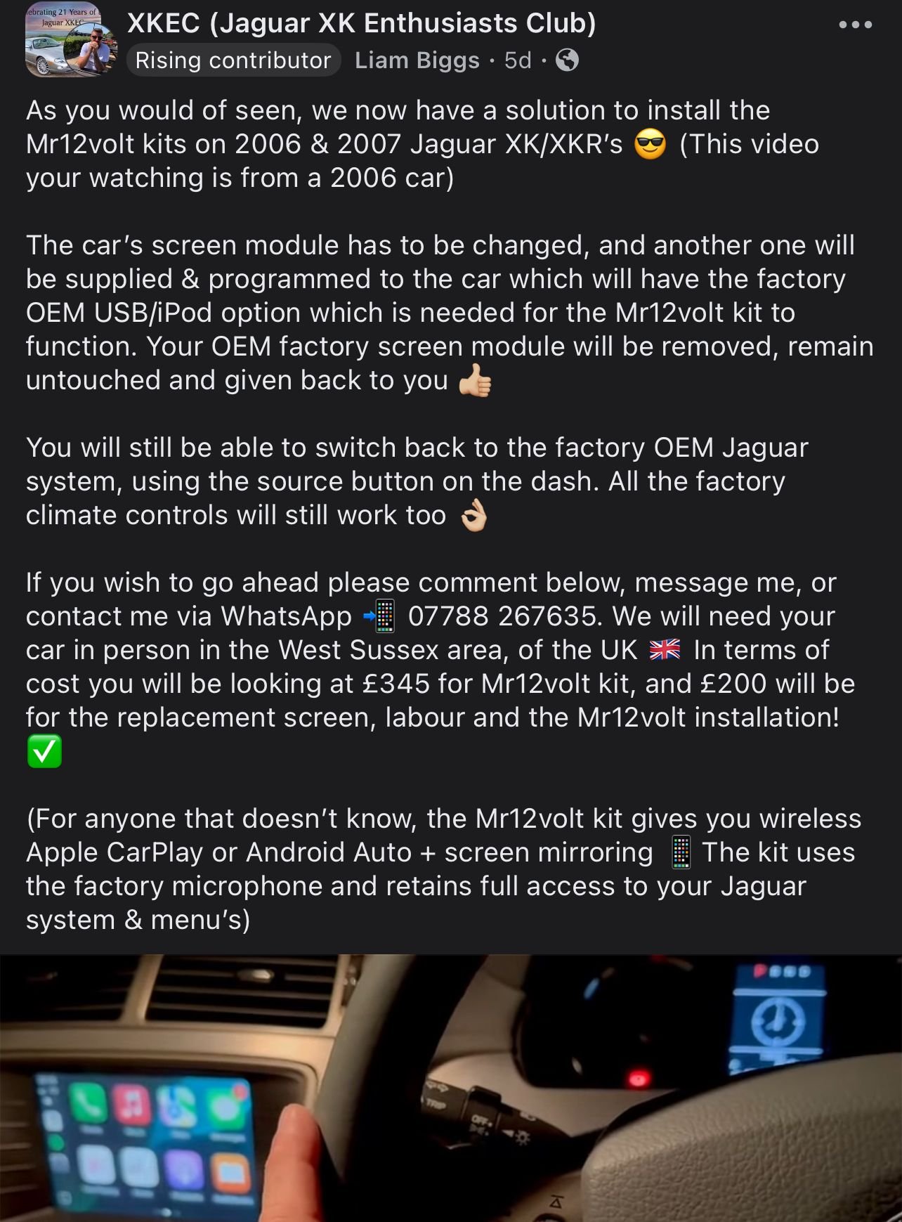

And what they are doing for the 06 (Britain) is replacing/flashing the head unit for an extra £200 then installing Mr12V, basically what Sean did way back.
Liam repeatedly says 06/07 (which is 07/08 in the US), but from the many convos here, it seems the portable audio option (all that’s needed enabled) is on the 08 head units.
Image of his post 5d ago:
