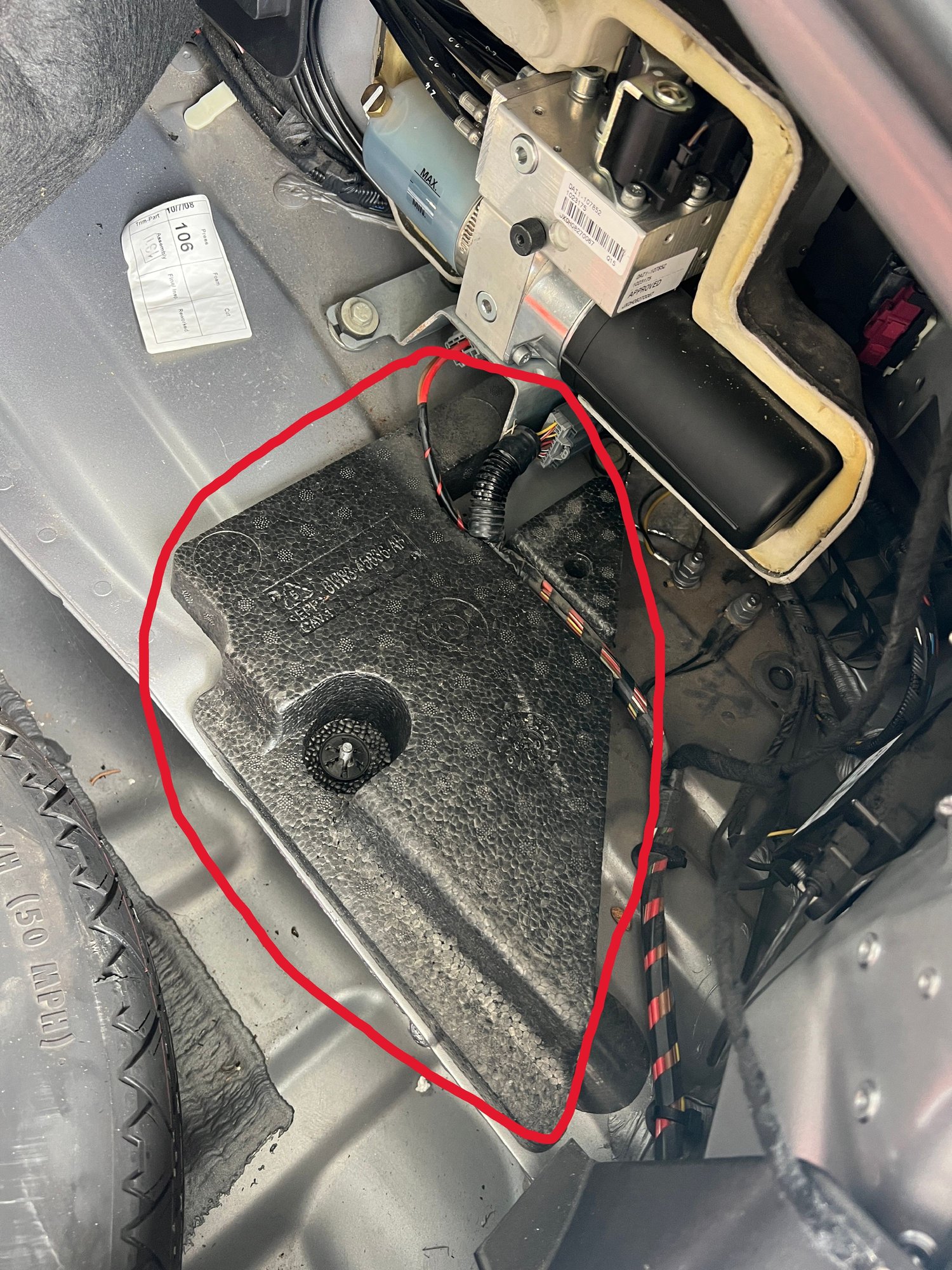

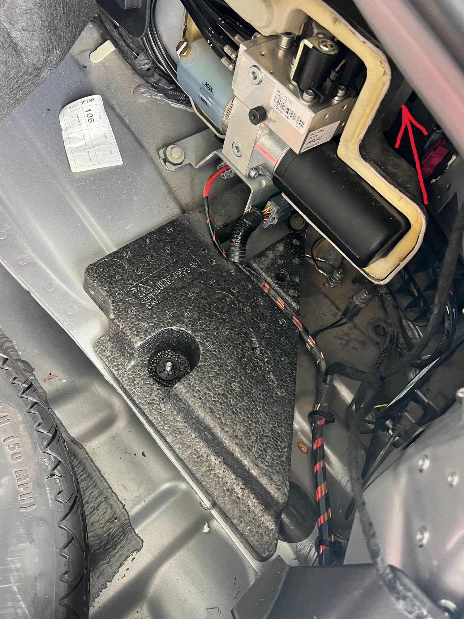

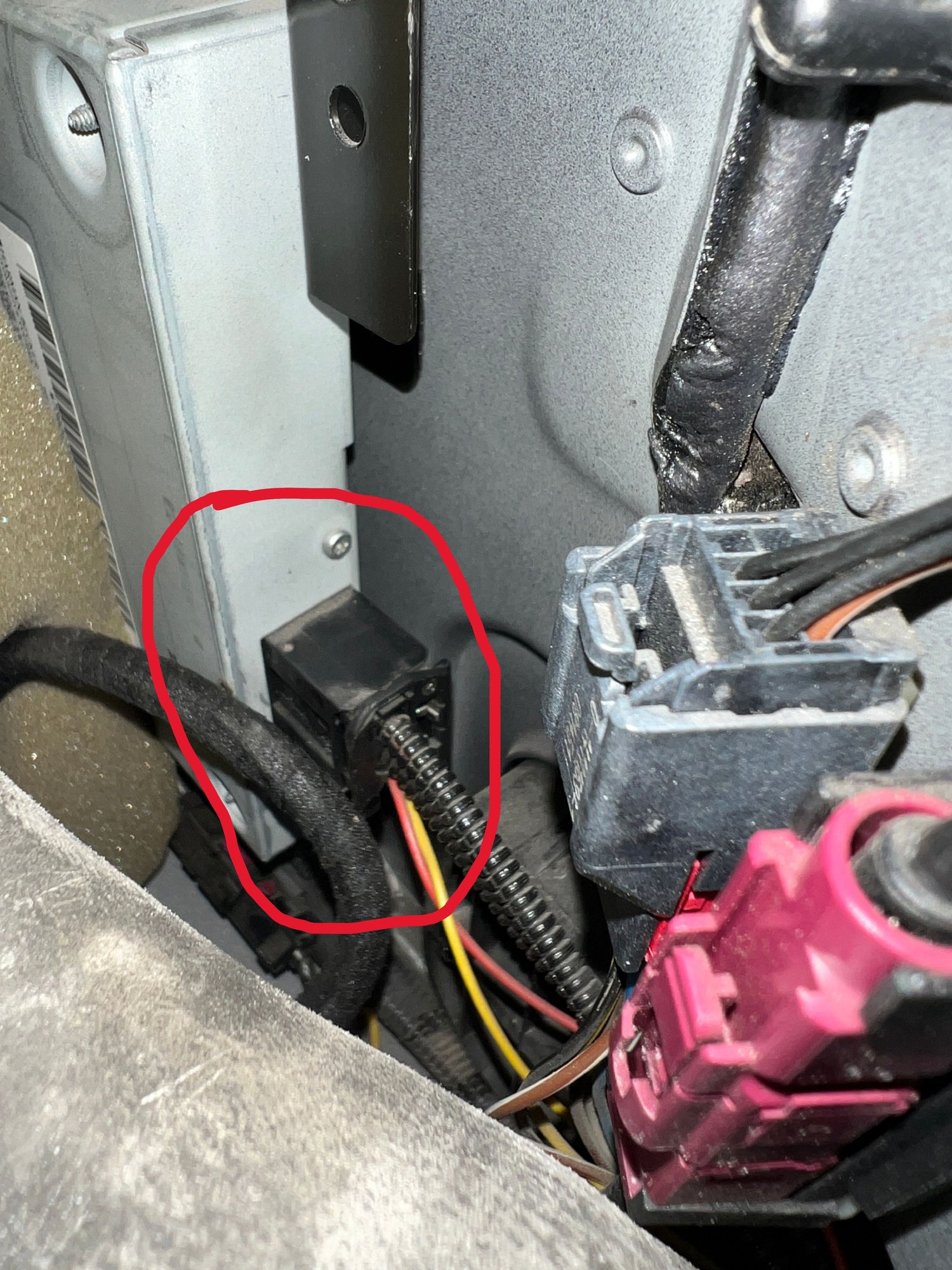

A bit of a hassle to get to the USB/Portable audio module which, in the convertible is right behind the convertible top pump, rear right. There's some black padding on the trunk floor which would be best removed to give better hand access to behind pump to remove the MOST plug from module. There's a tab on the plug which you'd need to 'feel' and press and the MOST fibre connector comes loose. Care needs to be taken with the orange fibre cables so as not to kink them.

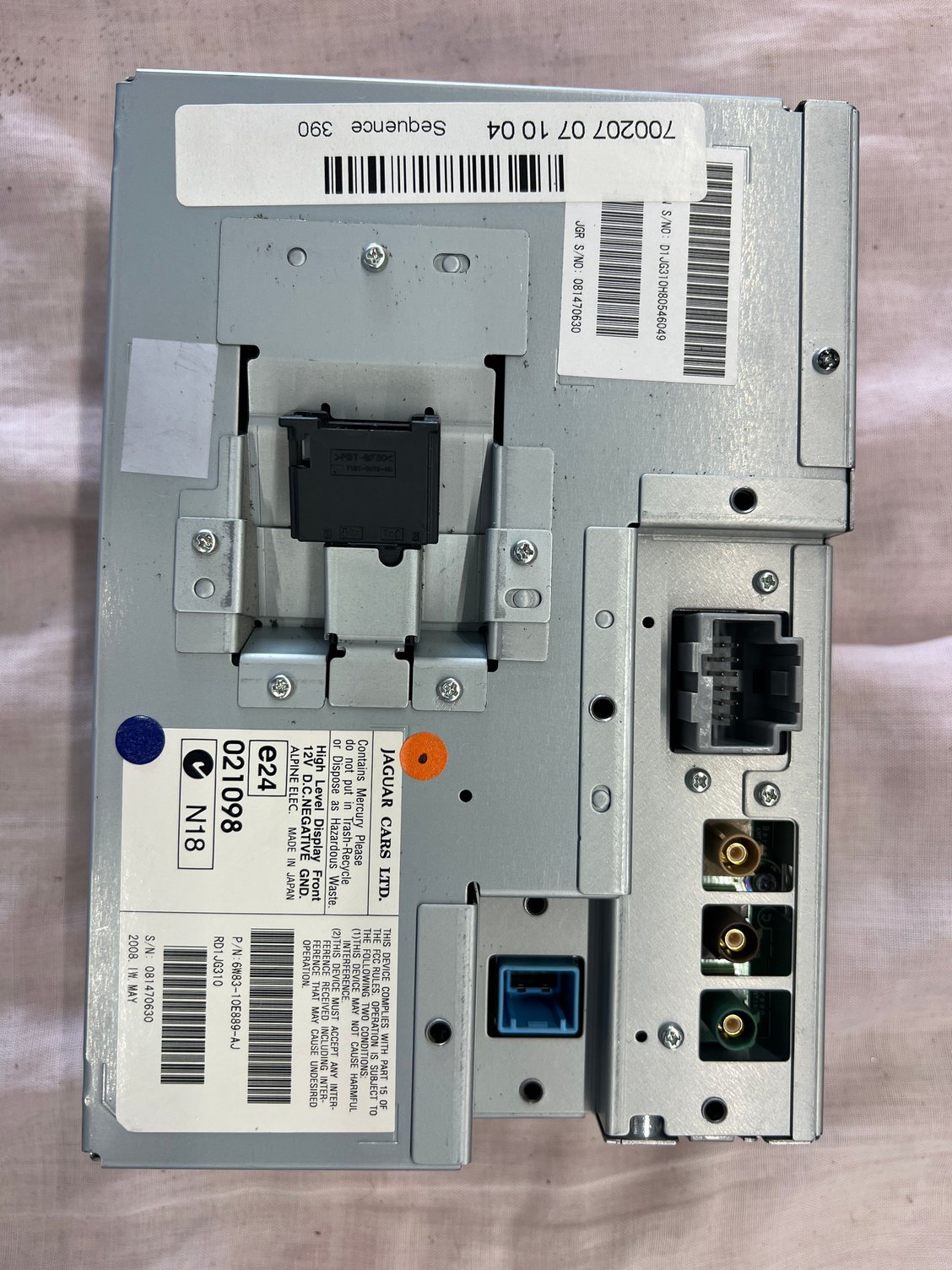

Doing the modification in the head unit is relatively straightforward … just be mindful that the ribbon cables need to be fully inserted in their slot. Some of them have an indicator line to show how further into the socket they'd need to go before you clip them in.
In my case, I seem to have an earlier head unit, so I had to use the 30 to 40 pin cable adapter. I was missing this from the Mr12Volt package and Liam organised shipment within a few days.

USB/Portable audio module is behind convertible top pump at arrow
You need to get to this connector ...
Best to remove this padding to reach connector ...

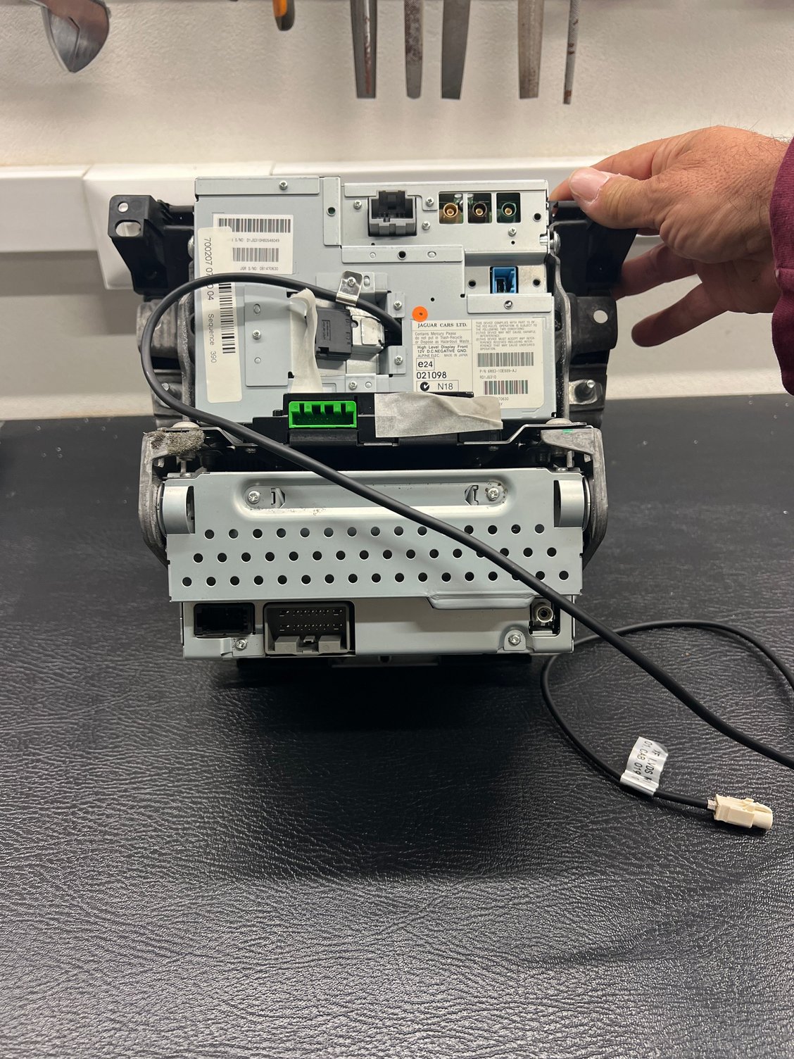

Head module back
Head module back
Was missing these adapters from Mr12Volt package ...
Back of control panel after modification ...

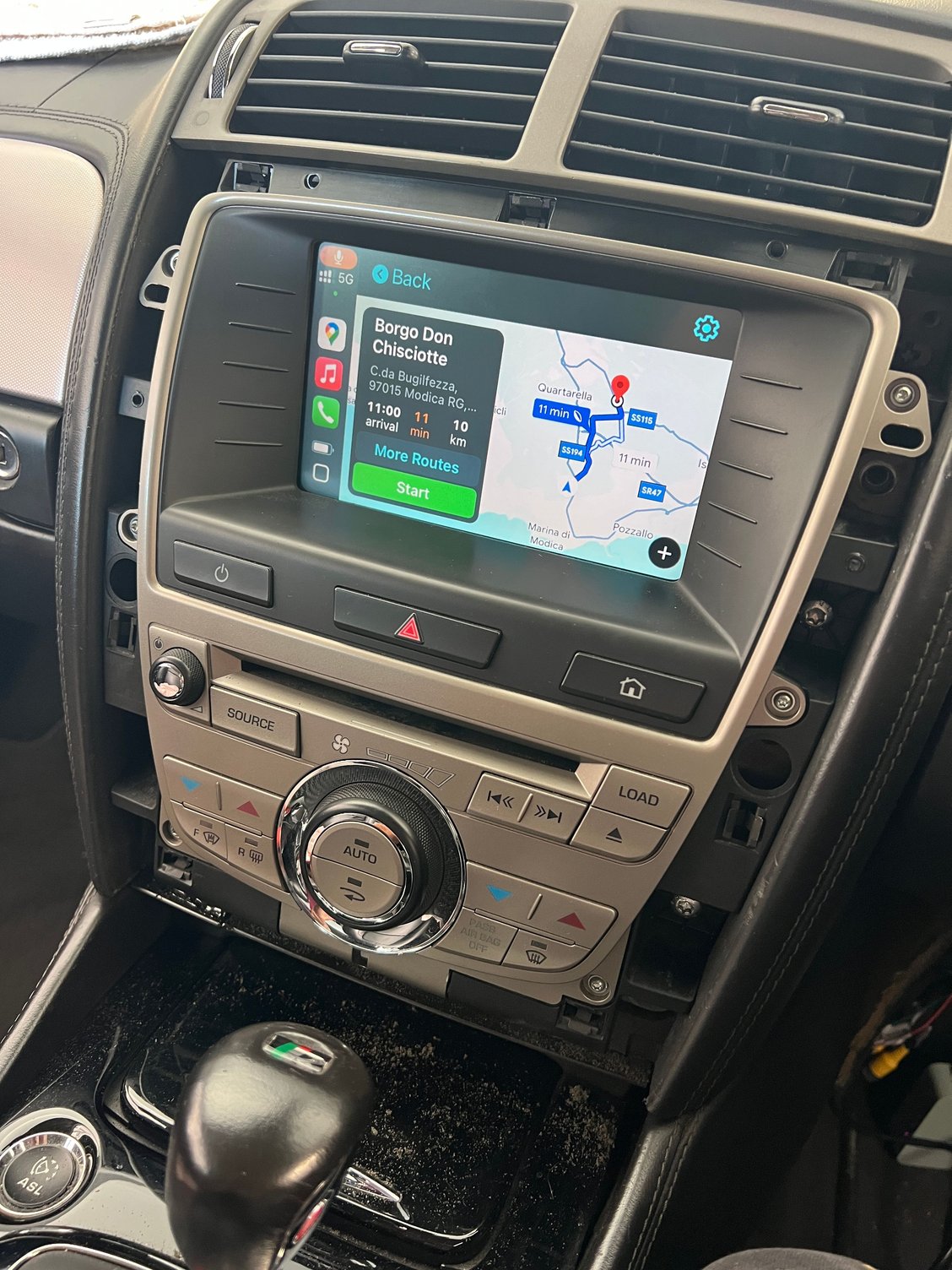

Carplay working ...
Carplay working ...
