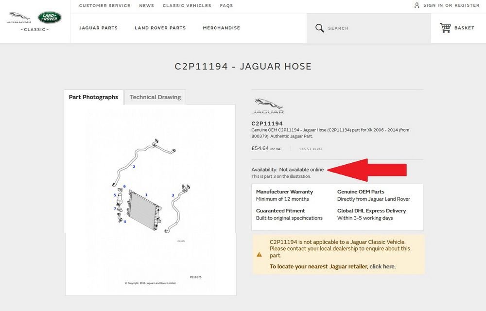

For future reference, you can find out IF a part is available AND the cost from Jaguar Classic site:
https://parts.jaguarlandroverclassic...1194-hose.html
Where a part is still available, it may be obtainable through Jaguar Classic but otherwise shows Please contact your local dealership like this example. Parts that JLR no longer supply directly or through dealerships are listed as NLA (No Longer Available).
It can save a lot of time and searching to know if an OEM part is still available or now unobtainable from Jaguar.
