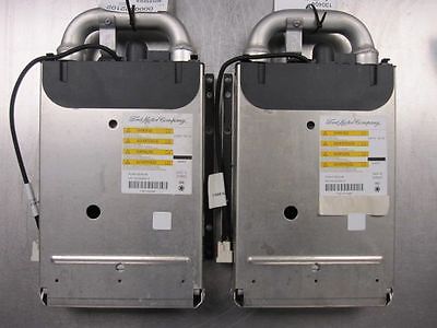

Old Jan 7, 2014 | 12:57 PM
+1
Two units fitted which deploy during rollover:

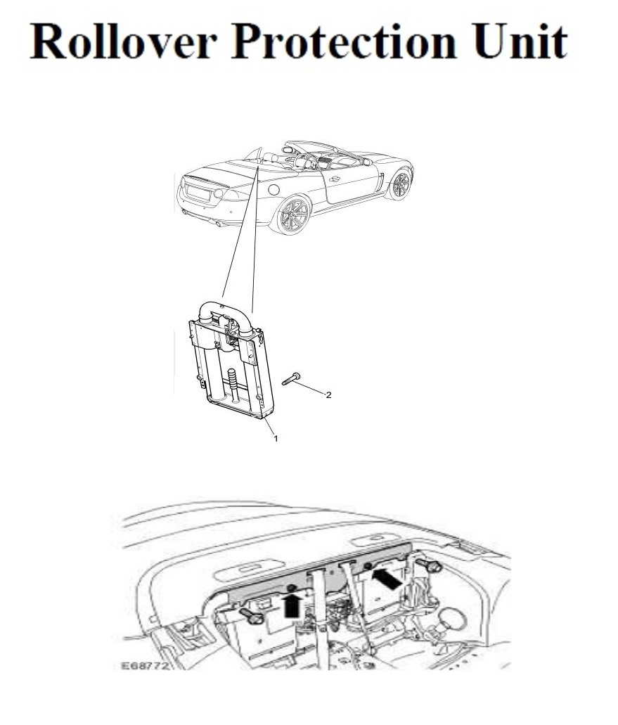

The roll bars are themselves are spring loaded with powerful springs. A small charge needs to detonate them (like an airbag) to release the retaining latch very quickly to deploy them. Then they spring open and lock. Also like an airbag, they are one-time use modules. The deployment sensors are elsewhere in the vehicle and not in the modules themselves.
Additionally, each roll bar has a glass fracturing pin on the top of the hoop to destroy the safety glass in the rear window of the convertible top when they are deployed and the top is up.
Attached Thumbnails Naive question on verts-x150-rollbars.jpg   Naive question on verts-x150-rollbar2.jpg
