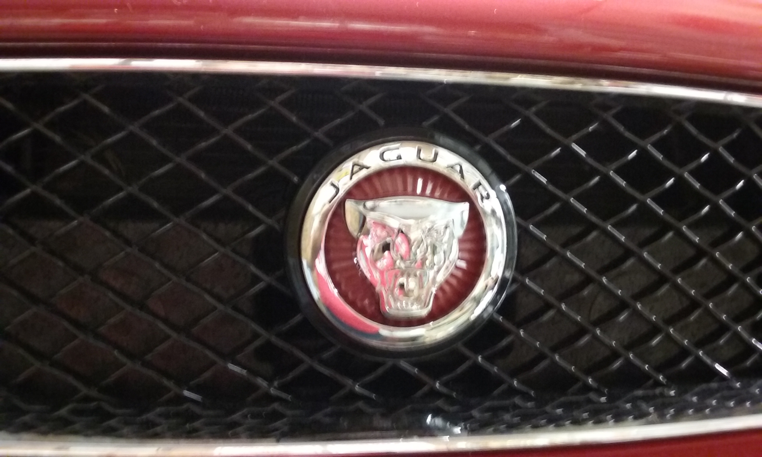

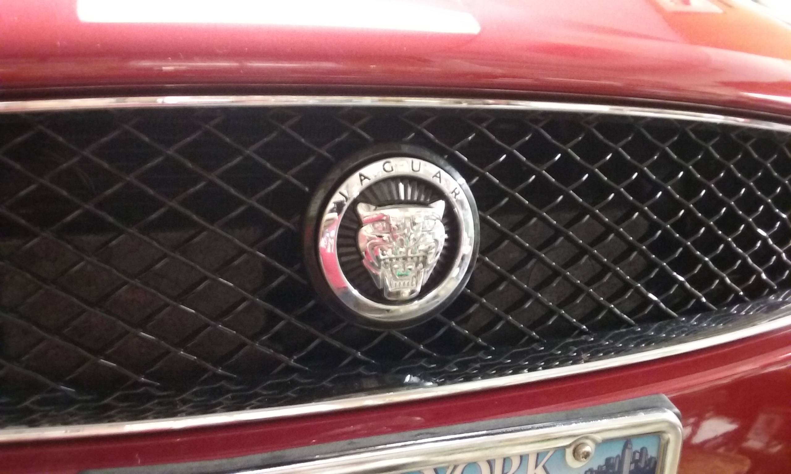

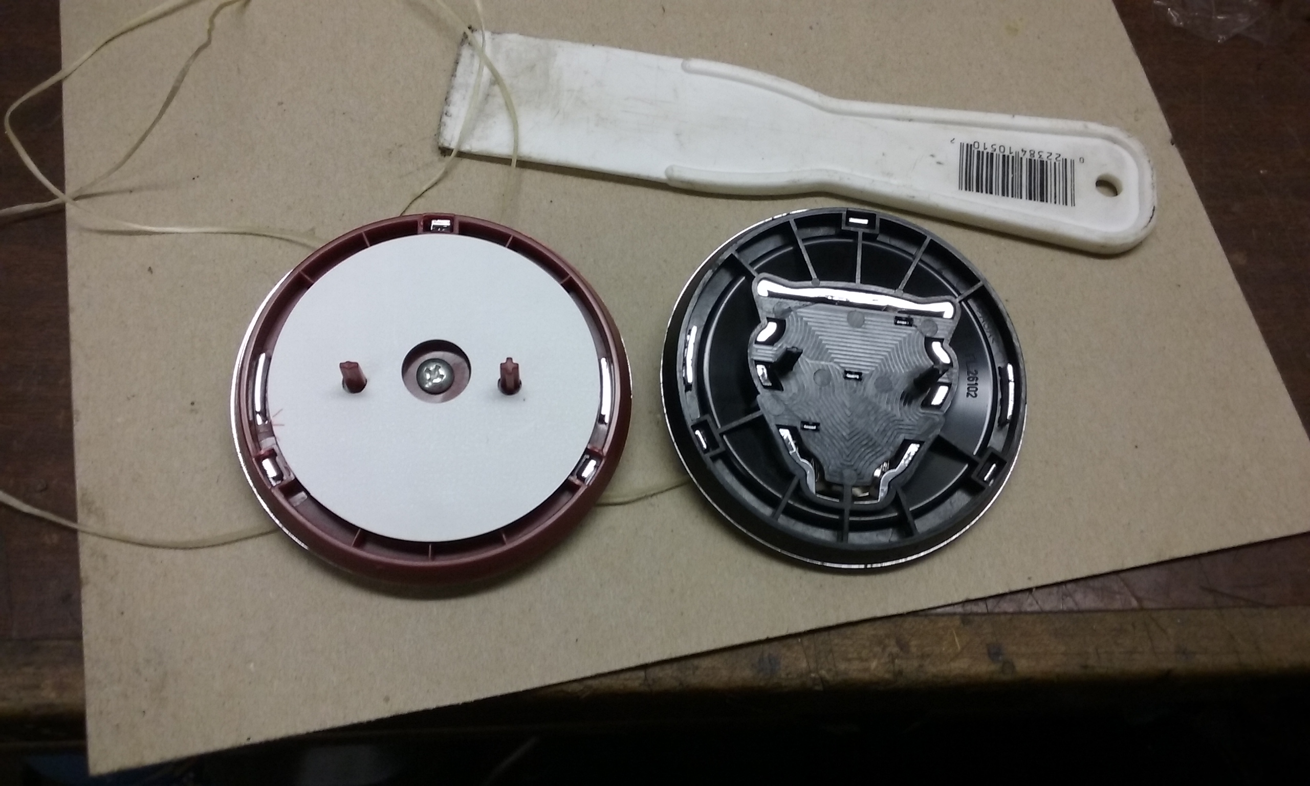

OK I just took the challenge and installed the red badge that I bought a few months ago. I did it without removing the grill and only used a piece of waxed (strong) string and a plastic putty knife. The whole process took 10 minutes. 1st get the putty knife behind the badge then work the string behind it. Use a sawing action and saw half way down and then again half way up . There are 2 plastic pins on the badge. Once loose work the badge off using your fingers. Clean off the glue material and stick on the new badge. 2012 XKR

As can be seen in the pictures posted by GGG and JackJohn, the early model emblems protrude more than the later models, as posted by jagtoes.
So katmac, the emblem you got from the dealer looks like the one jagtoes just took off, a flatter design.

Just and FYI here about the nut/screw on the back. On the red replacement badge there is a screw in the center but it is there to hold the Jaguar face. The design is 2 piece so they need to screw the face on. On my black background badge there was no screw and the face popped off when I dropped it. That is most likely why they screwed on the later design. The badge is held on with double sided tape only.

Yup, the one I have is the black faced one, double sided tape, nothing in the center, just the two posts on there. I'm debating snapping the bloody things off and just sticking it on and hoping for the best, but I realize that's just my frustration talking.
