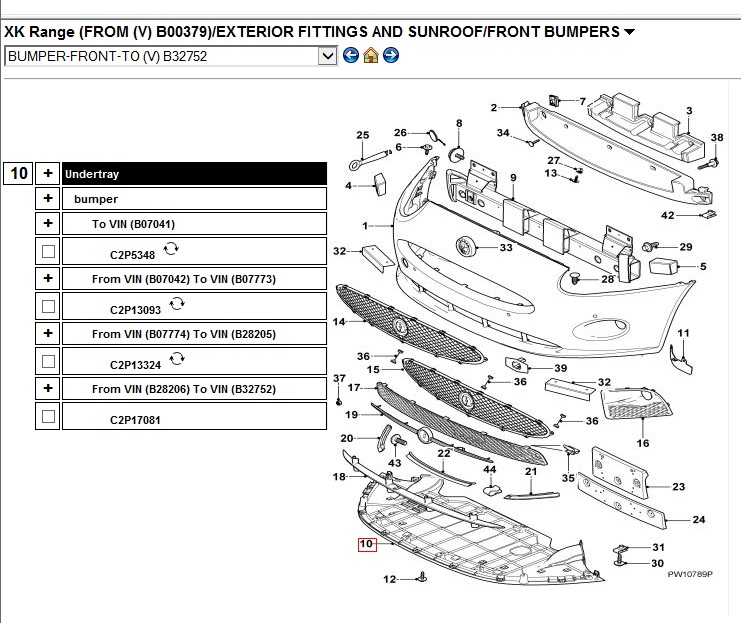

There's four different Part Numbers listed for the XK Undertray (item 10) depending on VIN.

This is not something I would recommend that you buy used, since they are often damaged. There is also a rubber wear strip that helps protect the car when bottoming out on curbs.
If you do not want to pay dealer prices, get it from a discount online dealer, like JPAM parts. You will not find this aftermarket.
