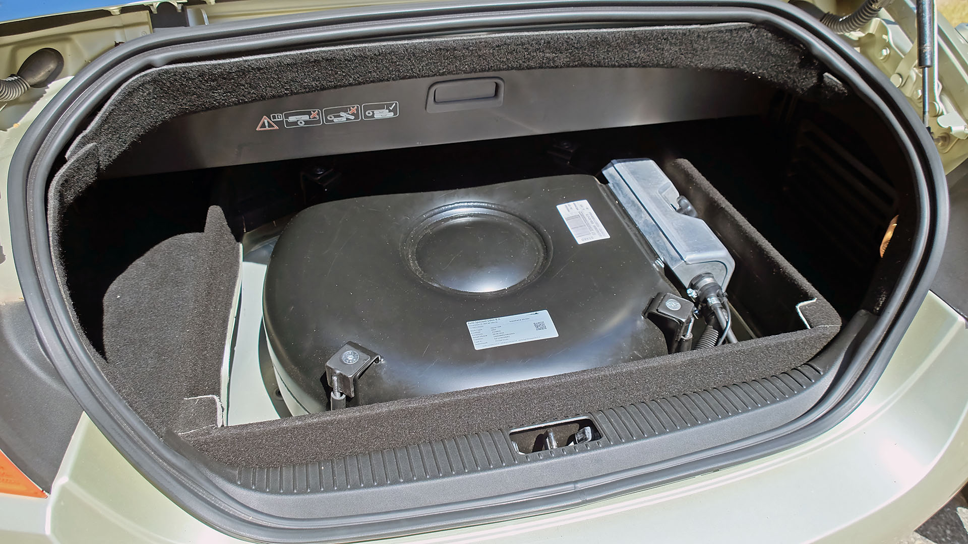

Trunk, with raised plateau
Trunk with LPG-tank exposed

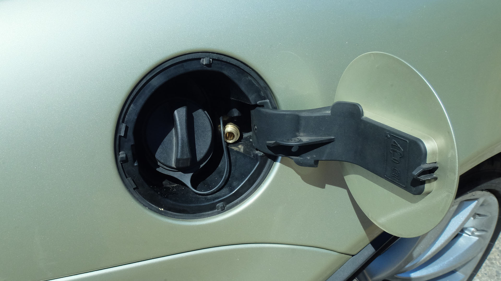

Fuel filler location. To be able to fill, an extension has to be screwed onto it, something like this.

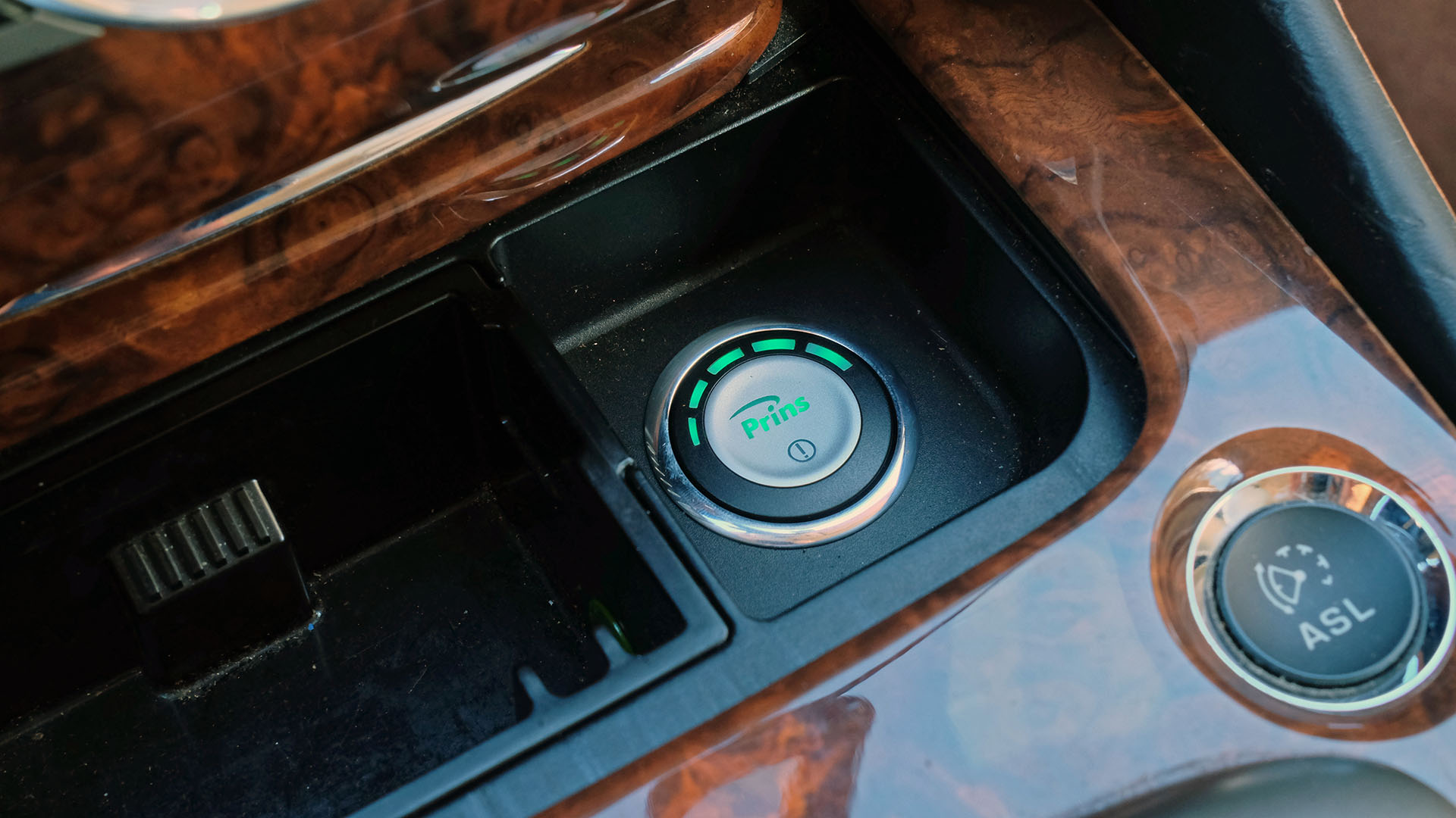

Location of the LPG switch button

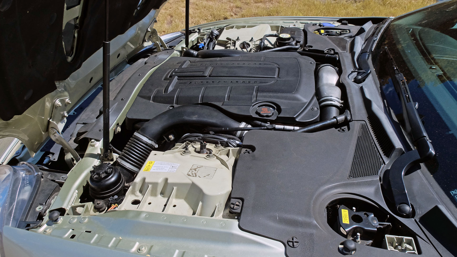

The engine bay, nothing much to see here.
Just visible, the LPG injector rail

In the UK lpg filling stations will not allow you to use adaptors, so I went for a towbar fill on my old car, meant I could pull up either side of the pump, as seen in pic below.

The install on my old car looked the same in the boot department, what I chose to do was to buy a cheap rubber boot liner to cover the tank, this meant minimal loss of boot space.
