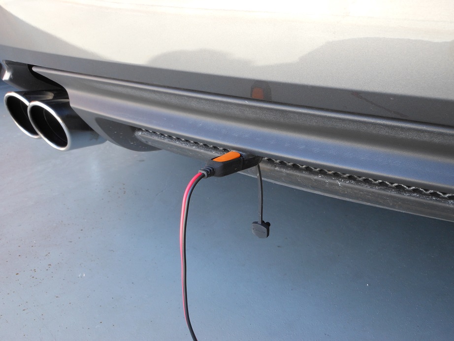

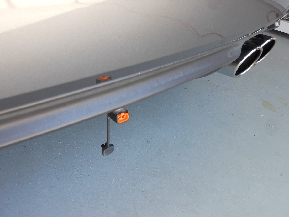

On your model (2007) you can connect directly to the battery terminals, bypass opening the trunk, by using a CTEK branded maintainer and using the CTEK Comfort Extension for a quick release and connect.
I have attached a few photos of my connection. It is quite naive for any Jaguar owner as stated above that you don't need a battery maintainer, and that if they have a battery problem they will sell the car. That is a crazy statement.
Many Jaguar owners will agree it makes a lot of sense to protect your ride by keeping the battery well maintained and powerful. For those that don't, eventually they will get bitten by the an electrical gremlin, most likely related to the battery.
Here's a simple solution to making it easy to connect a CTEK MUS 4.3 to your Jaguar.

Ref the battery maintainer. I have 4 vehicles and all of them get connected to a CTEK MUS 4.3 battery maintainer. Cost is under $68.00 at Amazon. I have written extensively on this forum about battery maintainers and particular the CTEK brand.
Your Jaguar is loaded with electronics and electronic sensors. The biggest issue that arises on these Jaguars are electrical issues and most of the time battery related. When I pull my XKR into the garage, the XKR gets connected to the CTEK immediately. It takes less than 15 seconds to connect.
I suggest you review this thread I personally started. The thread has over 36,600 views and over 260 responses. While the thread originally mentioned the CTEK 3300, I now suggest and recommend the CTEK MUS 4.3 which is an 8 Step battery maintainer.
Here's the thread link for your review.
https://www.jaguarforums.com/forum/x...lation-107738/
Don't cut yourself short by trying to save $68.00. Buying the CTEK MUS 4.3 will be one of the best investments you can make for your Jaguar. Be sure to also buy the CTEK Comfort Extension for an additional 8' ft of cord.
