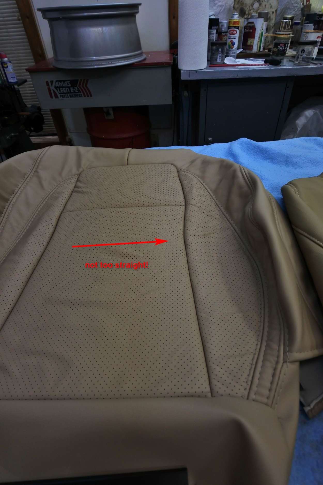

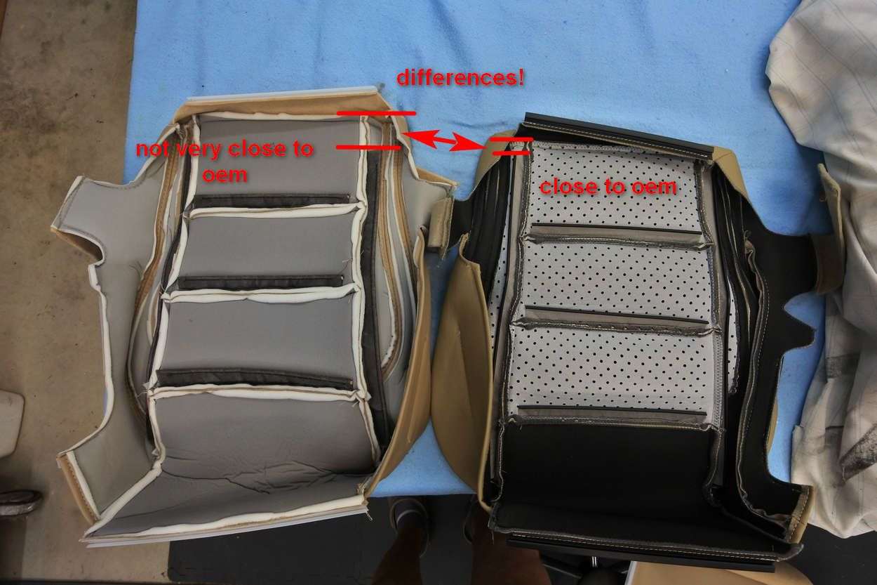

The leather is thicker and a bit more supple ASR:LS
The padding is thicker and a higher quality ASR:LS
The accuracy of the panel sizing is ‘closer’ to OEM, ASR:LS
but still off

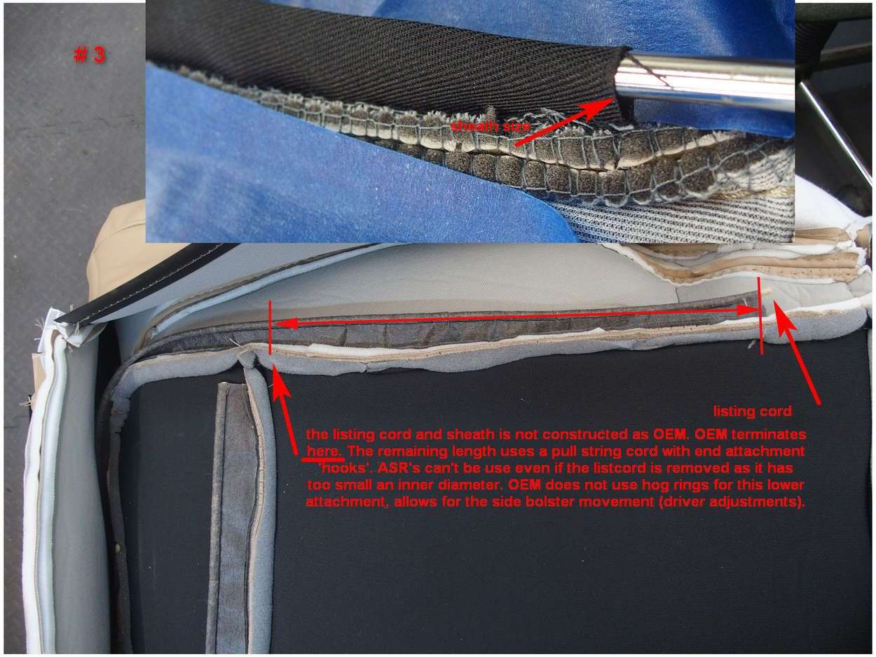

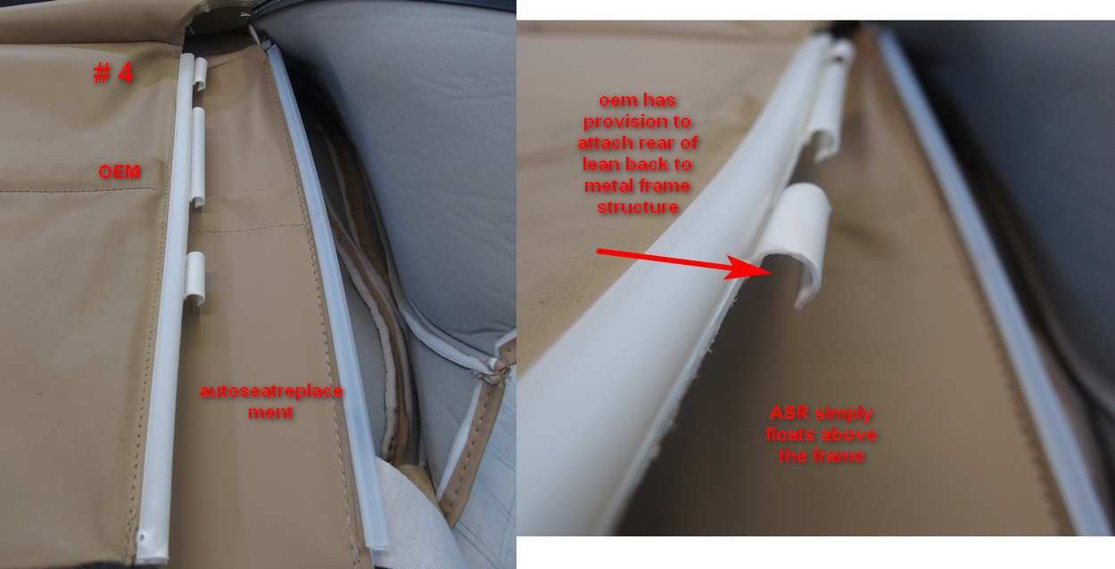

The lean back mounting approach is ‘closer’ to OEM LS:ASR
in fact the ASR mounting would need to be significantly modified in order to mount like OEM. (and this would result in the cover not being returnable; the seat bottom suffers from missing the correct mounting dimension)
The Airbag provision of LS matches OEM; ASR does not offer an Airbag provision.
Thread count; OEM = 6spi, LS=4spi ASR=3spi
The 4spi looks good both externally and internally, the ASR might hold in high stress areas but I wouldn’t trust it especially around the seat back release.
I concluded that since I was and am still prepared to pull the seat once more I’m going to order some OEM quality foam padding and fit it to the currently installed LS leather cover. ASR has been gracious to a fault and will be refunding me for this purchase.

to be honest, if the second set had better mounting I wouldn't have worried about the non-air bag or 3spi. I think it would 'naturally' fit better than the LSeat but since it looks like I'd still be tugging and pulling one way or the other I chickened out.
