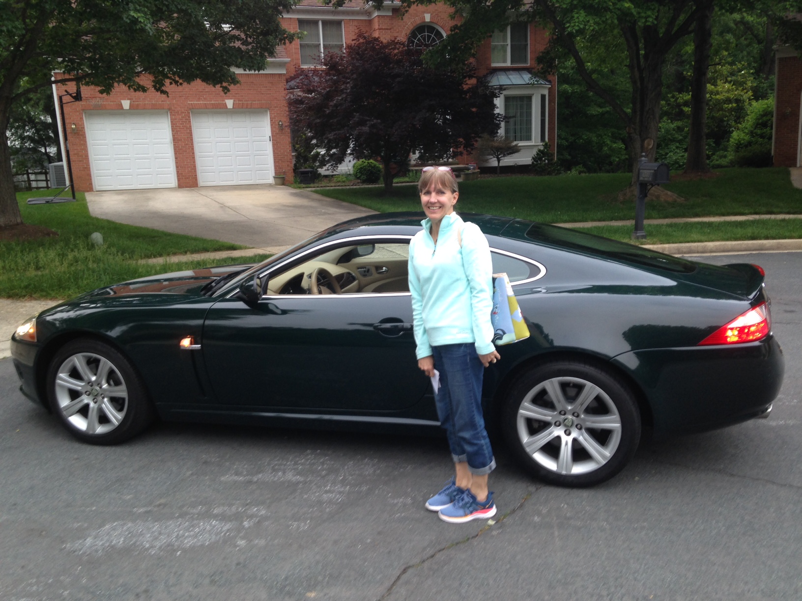

Picture! Its real!

Very nice!!! On the Antenna, a lot of people remove the fuse so the antenna does no go up, so check that first. Lots of '07 owners here so someone will chime in on the fuse location. If not, search the forum and it will come up.

What color is it? Interesting to see so many MD cars showing up.

Congrats on the new ride ! Looks great !!

On another note it is british racing green.

Beeeeuuuutiiiifulllll Jag you have there!

Very nice!!! Congratulations!!!
