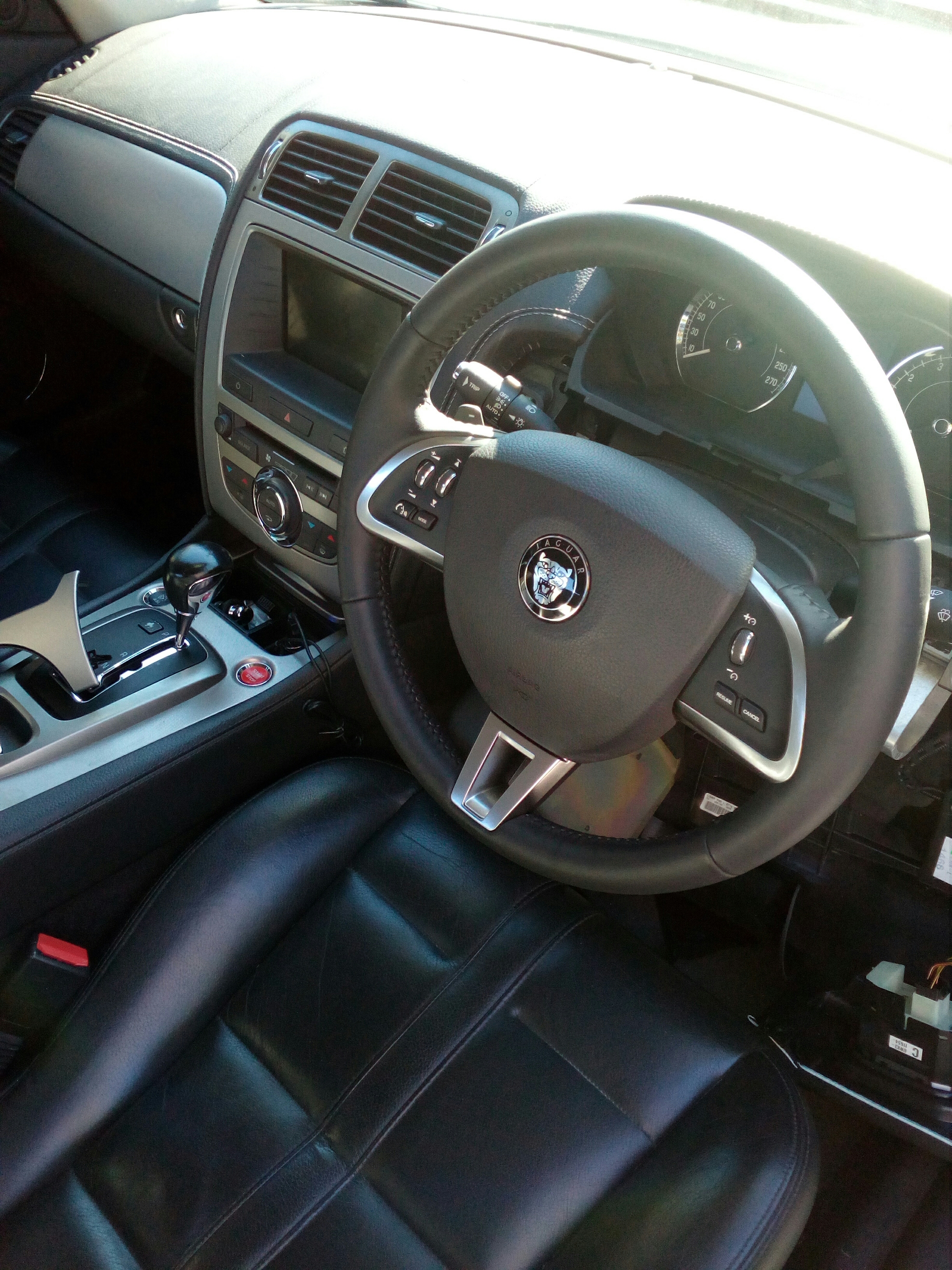

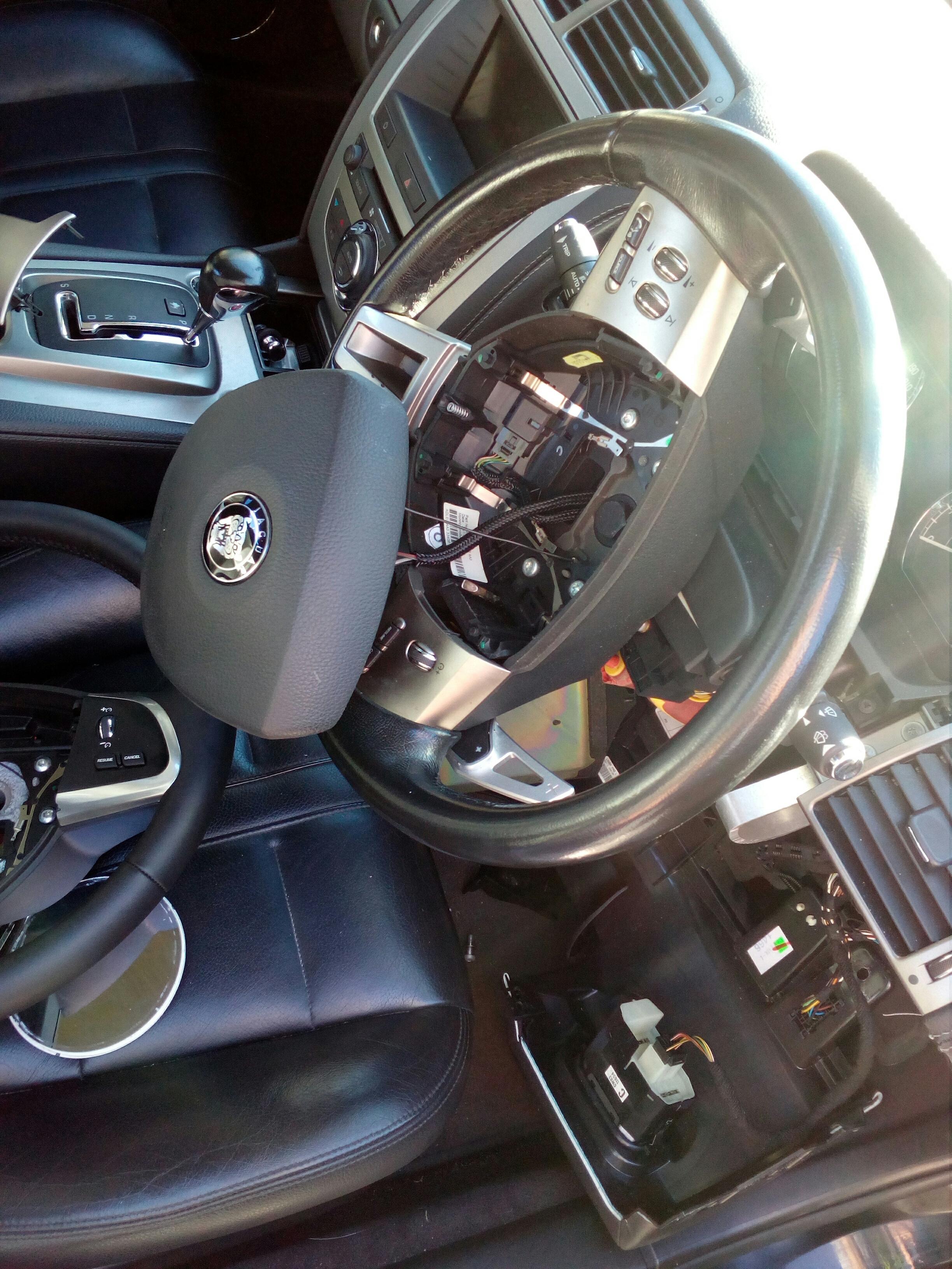

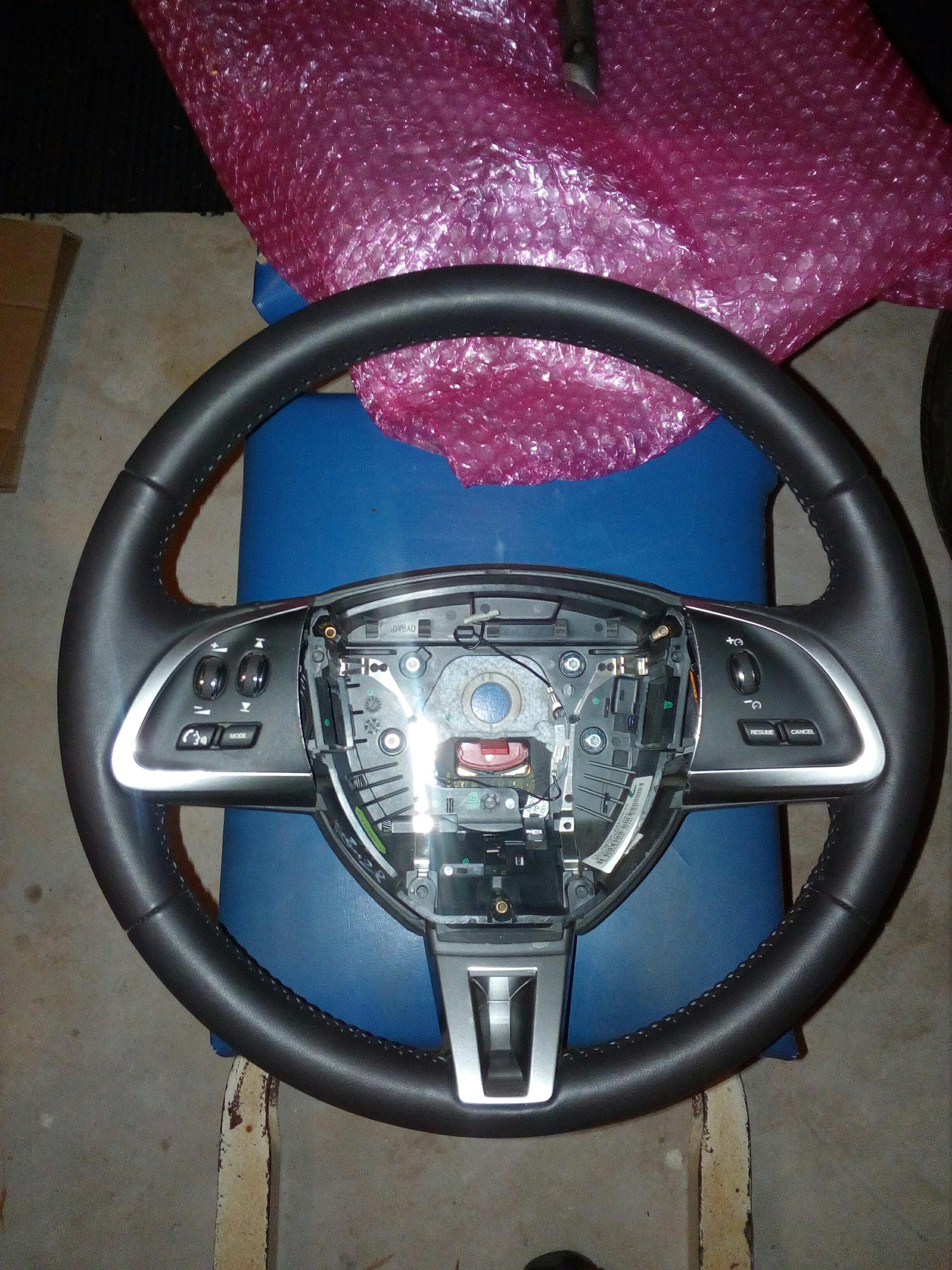

It's done
Would I do it again ..No
Next time could I live with a steering wheel that has done just over 60k km..Yes

Old Apr 14, 2017 | 03:12 AM
steve_k_xk's Avatar
Joined: Jun 2015
Posts: 3,005
Likes: 1,675
From: Sydney, Australia
I take it all back !! the car feels that more special with a fresh wheel !!
Highly recommended

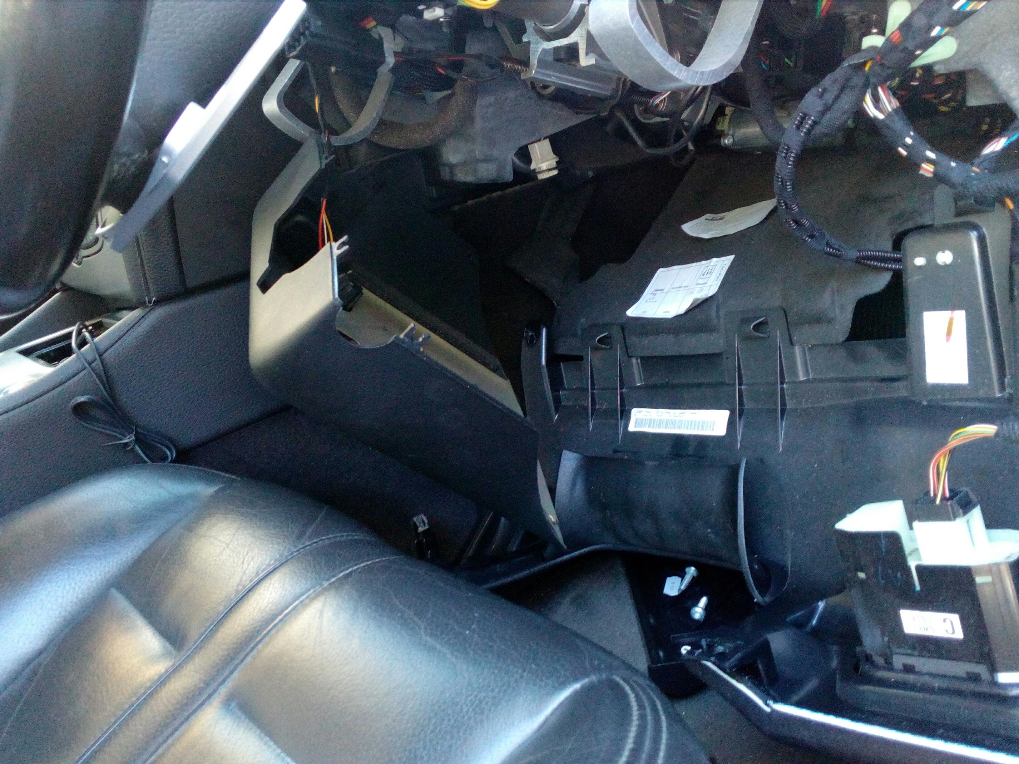

Nicely done…. how long from start to finish for the swap and did you encounter any real obstacle during the swap. Thx
Old Apr 14, 2017 | 08:58 PM
steve_k_xk's Avatar
Joined: Jun 2015
Posts: 3,005
Likes: 1,675
The lower dash will need to be removed to gain access to the rear of the wheel to pop the clips out
The key is obtaining the correct screwdriver for the job , as the screwdriver has to be inserted and then turned the few I tried seemed to be too narrow.. although with perseverance I prevail and actually bent the driver from the sheer force .
A screwdriver with a wider tip will make this job a little easier
