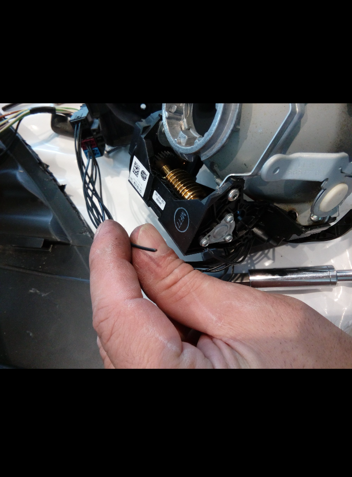

Have you checked all the wiring on all of the areas? That one guy in here took his lights apart and repaired a whole lot of burned/frayed wiring.
That may be a viable alternative, depending on your own circumstances.
there's a few of us that have done that I'm "one of those guys" lol

I also fixed mine when my car's left headlight was a lazy eye. It was that the wiring insulation was just falling off due to heat breakdown. I used my trusty weller portasol (like this:
Amazon Amazon
) and just cheapo flux and solder.
It's been a year since and no issues. If you can clean them up cosmetically, there is no way I'd pay $500-3000 a light for another unit. If it's used, it likely has the same thermal breakdown of the insulation that caused mine to act up; so fixing is the way to go. Mine polished up beautifully and have paint protection film on them now.

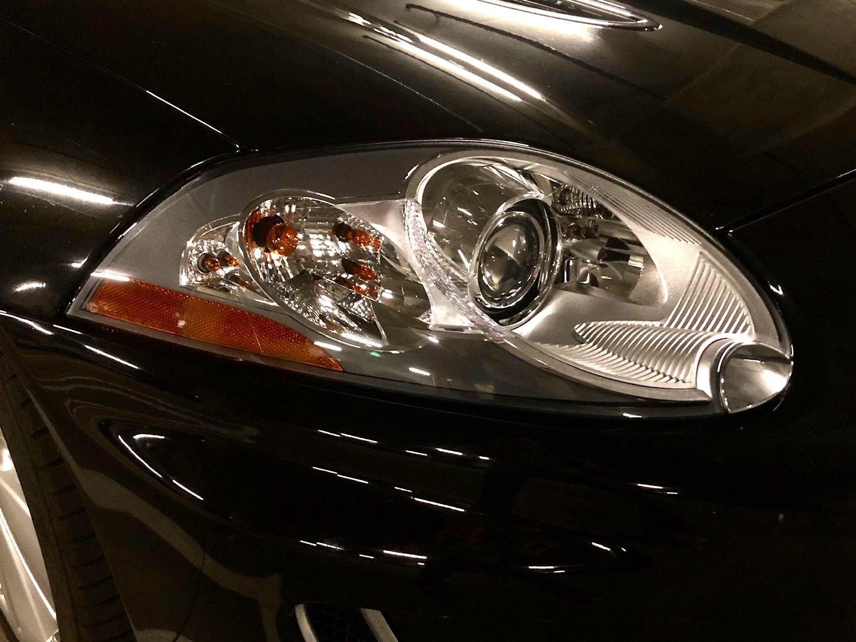

After three weeks and much searching, the service dept was able to source the left (drivers) side headlamp assembly, so both have been replaced!
Funny: I thought my headlights were in great shape cosmetically until I saw these new ones. Sa-weet!
I was told they don't think there's another new one for the left side anywhere in the US.
(And the cost listed was $3250 EACH. Thank god for the warranty....)
