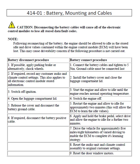

If you are not putting the car into a London Jaguar Dealer for the battery replacement, you should be aware that a number of adaptations are lost when the battery is disconnected and the following procedure should be used to reset them:

Do I need to drive the car immediately, or can it wait until the end of the day when I go home?
I am going to change the battery in work hours. My boss is fine with this, but not sure he will be happy with me vanishing off for 30 minutes.

If you can spare the time, it is best to fully charge a new battery on the bench overnight with a trickle charger before installation.

I'd suggest you do 1,2, 8 & 9, and leave 3-7 until you're headed home. There's no need to calibrate the ECM until you actually want to drive the car.
