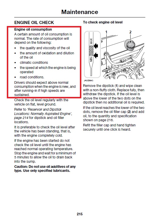

I was surprised to see this warning about oil consumption in the Owner's Handbook:
My previous XJ8, XK8 4.0 litre and XK8 4.2 litre never used any oil and Jaguar have never included this warning in other V8 model Handbooks.
I have consequently kept a close watch on oil level but even on two fast overnight trips of more than 700 miles each, the level has not dropped.
Old Feb 25, 2014 | 02:01 AM
Likes: 17,018
How are you supposed to read the oil level? When the car is cold? After cranking the engine?
See the extract page from the Owner's Handbook in my post #8 above.
