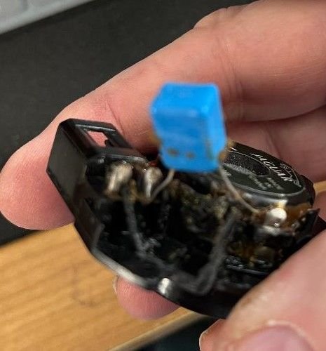

I have no idea about the value, but capacitors take out the low frequency from the input to the tweeter. Same way a coil takes the high frequency out of the input for woofers.

I don't think repairing the tweeter makes sense since I believe the lead that goes into the capacitor is what is missing from the tweeter, and I don't know another way to use the existing capacitor.
We all know the tweeters are rubbish, so I may order an aftermarket set made of silk or other nonmetallic material and put in the pillars. I would need to replace both. As for crossover, I can look to see what value capacitor is on similar jags and match, or I could even get a real two way crossover network for more effective maintenance of signals.

Using Acetone to get rid of the hot glue, I got the blue capacitor out of its seat on the non-working tweeter. There are no markings to note the value of it. It is a film capacitor which is a little better than an electrolytic. There is no break in the circuit, however, so either the capacitor went bad, or the tweeter itself. I really expected there to be a break in the connection.

I took the easiest way out on the tweeter issue. I found an exact replacement off the bay for $35 guaranteed good. I think that will work the easiest. Now to see if the Deox It cures the drop outs.

It took over two weeks to get a replacement tweeter in. It works. Also, since cleaning with Deoxit I've had no more channel drops. Thanks for all the help! However, I have a more important issue I have to handle right now with the car. I will start a new thread as it is engine related.

Aren't those Alpine speakers?
No, the tweeters I showed above are for the B&W system and are aluminum. The Alpine tweeters are a fabric dome.
