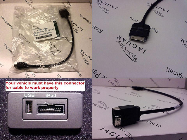

Default New iPod Interface Cable
[QUOTE=... Does anyone know if Jaguar has an iPod cable that will play/charge (5v output) simultaneously?[/QUOTE]
Answering my own question!
Starting with the 2010 model year, Jaguar revised the iPod interface cable to enable simultaneous play/charge. That part # is C2P21008 and it is expensive - around $100 from your Jaguar dealer. I was told that it will work on the 2009 XK/XKR models. Not sure if this cable will work with pre-2009 models with the dealer-installed ACM (Audio Connectivity Module).
I didn't order it yet. Instead, I ordered a Scosche passPORT charging adapter for $16 from Amazon as a less expensive alternative.
Amazon.com: Scosche passPORT Charging Adapter for iPod and iPhone (Black): MP3 Players & Accessories Amazon.com: Scosche passPORT Charging Adapter for iPod and iPhone (Black): MP3 Players & Accessories
I'll let you know if it works.
Stuart

Latest gen iPods and iPhones wouldn't work because apple changed the connector. I did buy the super expensive cable from Jag and it works with a whole range of ipods from the previous nano (the little square one) to both an iPhone 3G and 4G. All 3 of them charge too.
