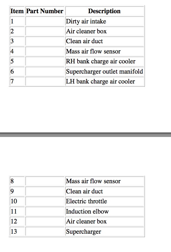

P0106 is not just MAP sensor failure, it can also be an intake leak or a wiring fault (sensor OK, wires disconnected/broken). The air intakes start up at the front, dive down to the filters in front of the wheel arches, then come back up to the rear of the supercharger:
P0108 MAP Sensor Question 2007 XKR-screen-shot-2014-06-09-20.27.25.jpgP0108 MAP Sensor Question 2007 XKR-screen-shot-2014-06-09-20.27.35.jpg
Does the whistle happen all the time, just on startup, or was it just once? If you can get it to repeat, an old-school mechanic's trick is to hold one end of a short plastic hose to your ear and point the other end at various places to localise the sound.
