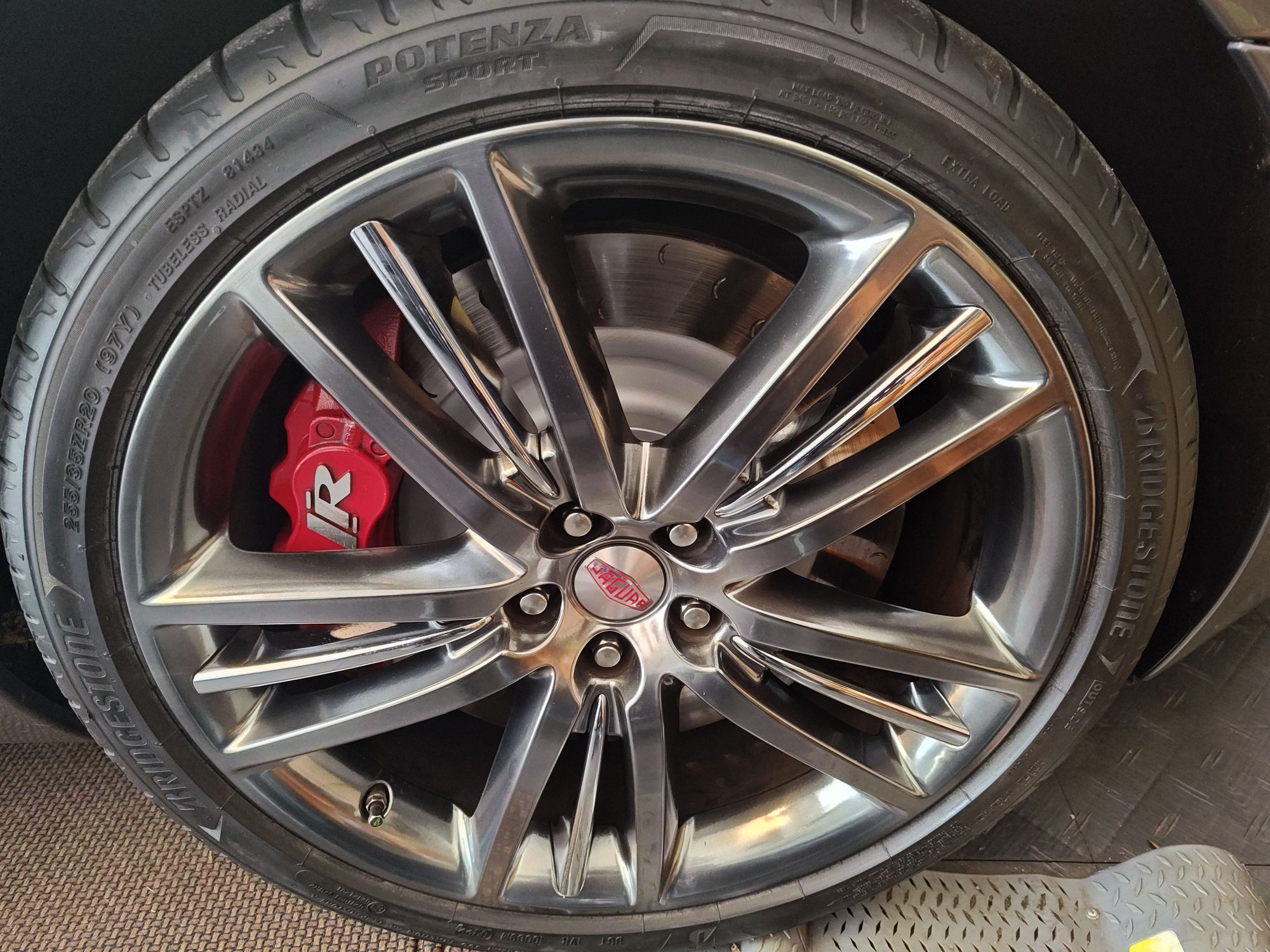

I can't give you any details about the paint, as everything was done by my Indy ASE-Certified technician: new Centric Alcon rotors and Brembo ceramic pads. The hats are matte grey. No more black brake dust! OEM 20" Selena wheels, exclusive to the 2009 XKR Portfolio models.

Potenza Sports. Nice tires. When F1 dropped them, all the drivers complained.
And before I’m called out for thread hijacking (glancing sideways at Stuart S) Both the grey and matching the calipers is quite nice.
We use lithium grease (sparingly) to ensure there’s no sticking.
I don’t mind the brake dust. It washes up in a jiffy with a sponge, warm water and a little organic cleaner called “hertel”.
It leaves a nice finish on the tires too. So no need to purchase any tire dressings.

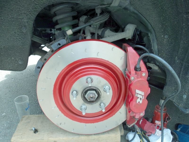

Originally Posted by XKDreams
…my ‘15 XKR has the red calipers, but no “R” logo on the calipers. Why is that? ...
You don't have the Alcon Performance Brake Package.
Alcon brakes were available only on 2008 and 2009 (4.2L) models. What made them special and expensive - a $5,000 option in 2009?
1. Calipers: painted red, both fronts and rears are cast with a raised //R Logo, (not a sticker). Fronts are printed "6 piston" and rears are not printed and have 4 pistons.
2. Discs: 400mm front, 350mm rears with crescent-shaped grooves. The largest ever fitted to a production Jaguar at that time.
