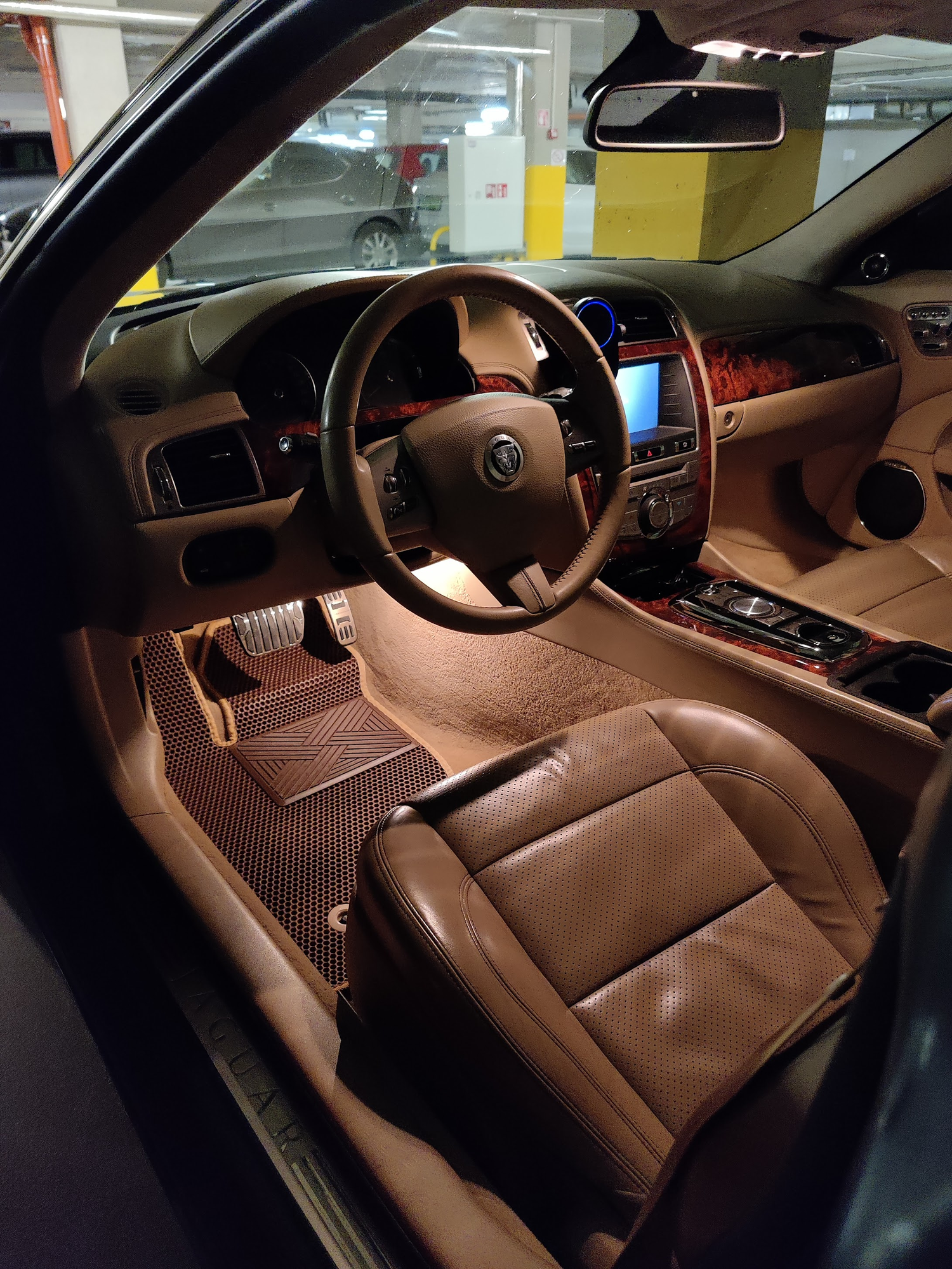

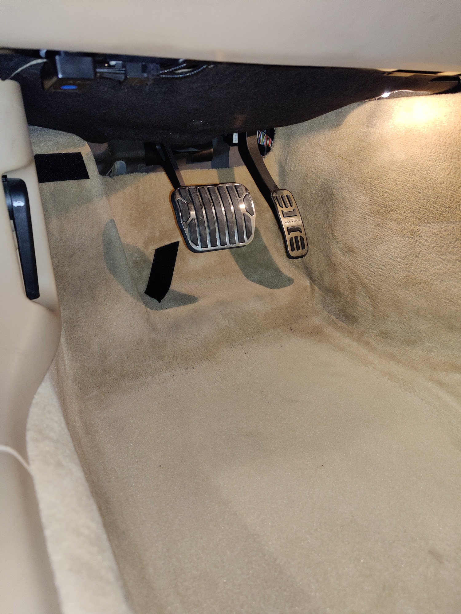

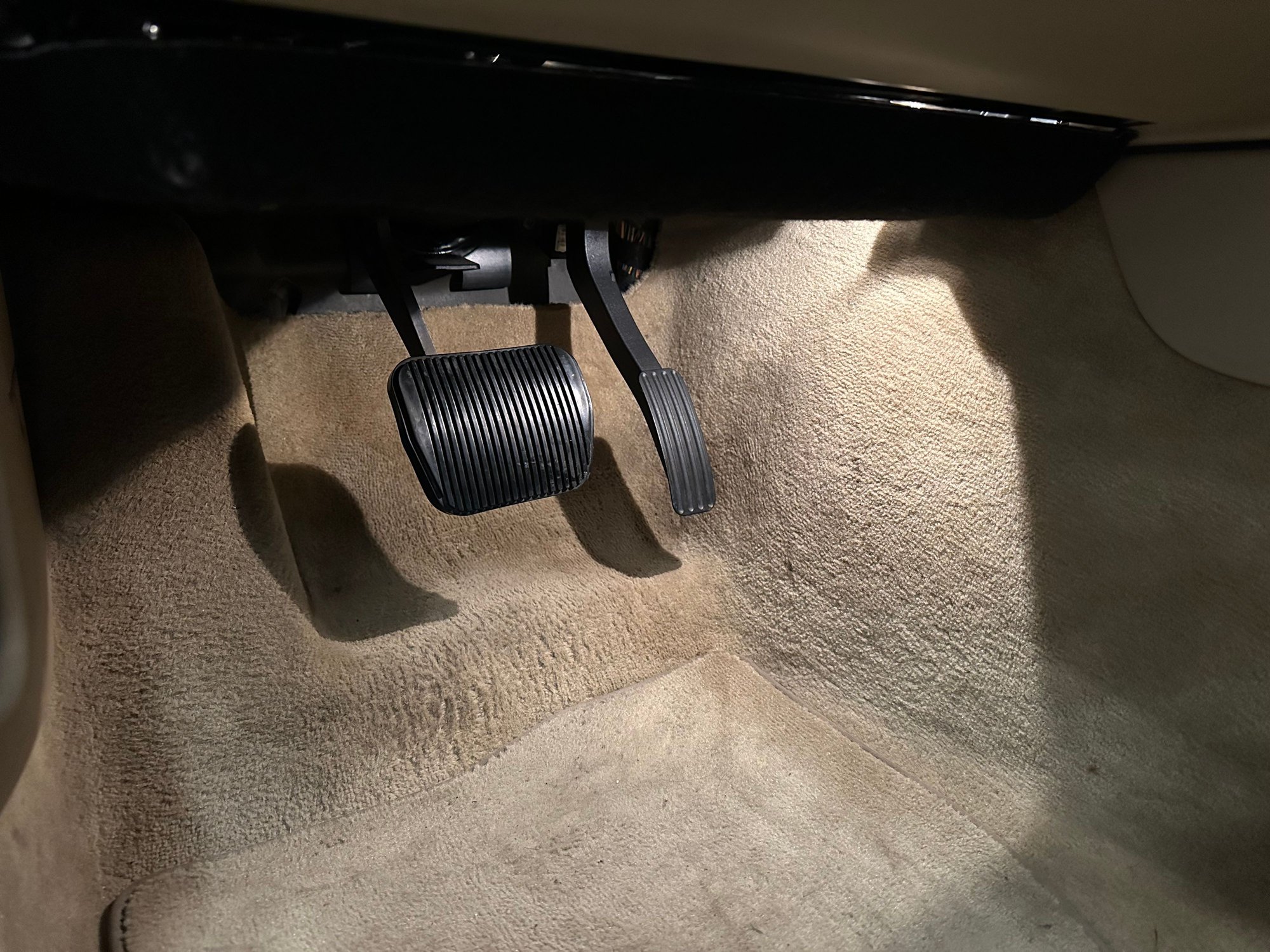

Hello - trying to solve a pedal issue. The brake pedal is much lower than the gas pedal.
could someone with a 2010 xkr take photos of their pedal offset?
mine for reference

I'd say your gas pedal is way too high. No idea how to remedy that though.

thank you very much! Confirmed my suspicions…

Quick update - I believe someone installed a XJR pedal incorrectly. The tell is the angle of the pedal and the extra material behind the first bend point, as well as the weird offset that gets the pedal closer to the transmission tunnel. New/used gas pedal ordered from eBay.

Correct XKR pedal installed.
Someone installed an XJR pedal which fcks with the position.

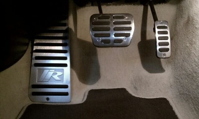

My 2009 XKR Portfolio Convertible came from the factory with covers over the gas and brake pedals. I added the custom made ​​​​​​//R logo footrest cover.
