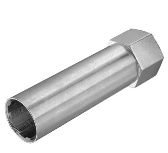

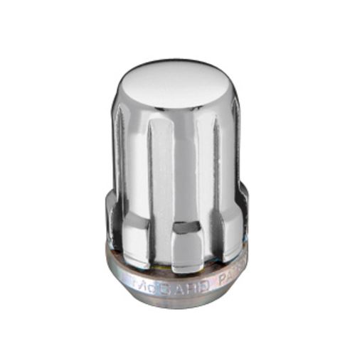

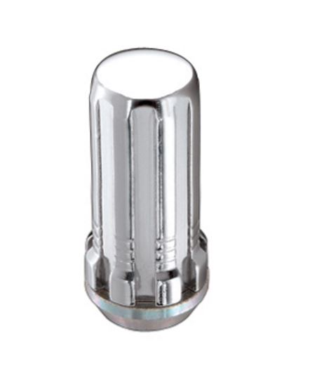

The lugs nuts used on the Jaguar XK/XKR will be dependent upon using OEM Jaguar wheels or aftermarket wheels.
While the "mag" lug nut or "flat" lugnut is suggested/recommended for OEM Jaguar wheels, it is not the case for aftermarket wheels used on a Jaguar XK/XKR. Each aftermarket may require a different lug nut vs the OEM Jaguar lug nut. It is important when buying any aftermarket wheel to make sure you have the proper fitment of lug nuts.
Many of the aftermarket wheels sold will use a spline (tuner) lug nut. This is because the OEM Jaguar lug nuts will not fit the bore of the lug nut hole.
Here's what a "spline" lug nut looks like, and requires a "spline" lug nut wrench.
Click the image to enlarge, click again for full screen.
Picked up a nail yesterday/tire opinions-spline-drive-lug-nut.jpg   Picked up a nail yesterday/tire opinions-spline-drive-lug-nut-2.jpg   Picked up a nail yesterday/tire opinions-spline-drive-lug-nut-tool.jpg
