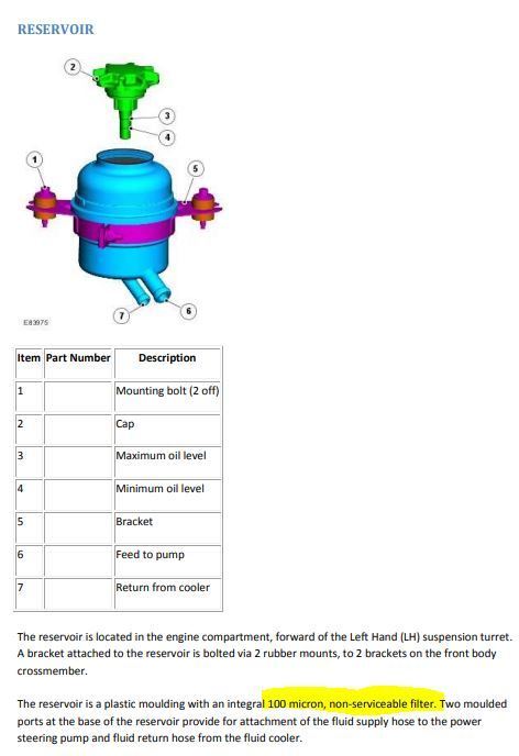

Everyone's got their service targets, but I generally agree to 50-70K miles (for PS fluid, based on what I saw in BMW's 5 series). BMW used both ATF and CHF11 (hydraulic fluid) in different cars. Can't mix them, though. System is almost the exact same configuration/design as the 5, 6, and 7 series. As usual, lubricant is cheap; metal is expensive.
Can't speak to the "no filter" bit. Maybe Jag's part doesn't have one (but I'm skeptical -- they're made by the same company). But every BMW reservoir does, and the BMW one I'm ordering to replace the Jag one certainly does.
OK, alternative methods:
The turkey baster method gets a lot out, but I was always suspicious that the filter would get clogged and circulation would be restricted at high mileage. And everything I pulled was above the filter.
So, after using the turkey baster method, I tried the "suck it out of the feed hoses" method, which got more out, then replaced the reservoir/filter to refresh the filtering. Clearly could see better flow in the reservoir.
Jag recommends the full flush (section of the maintenance manual attached) that feeds a continuous flow of new fluid as it pumps out the old. Seems pretty good to me, since you likely only do it once in a very long while, and steering racks are %^$#@ing expensive on our 6-13 year old XK's. Of course, they recommend replacing the reservoir/filter. BTW, this is a messy job, even if you suck out the reservoir carefully. Some pigmat or a big handful of paper towels are a good idea to catch the fluid that flows out of even an "empty" reservoir when you disconnect the hoses.
I've got my filter coming in and plan to do a jag-type flush next week. They say 4 L of Dex 3 to do a complete fluid refresh. No, the system doesn't take 4 liters -- they use that much to clean out the cooler as well, and there;'s some extra wasted as new pushes out old. Don't forget: If you don't have hose clamp crimping tools, a couple of screw on hose clamps will do.

Tks, I just ordered a factory manual as I am certainly missing some stuff here. Seems simple enough to me but do you have a part number for the filter? I did not see that step in what you sent me. I am sure i will find it when the manuals arrive though. So strange that the dealer is not on top of this. They make a ton of money on maintenance, especially when someone is willing to pay. I know Cadillac and Mercedes has that dialed in and actually come and get my car to perform the financial hosing, but they also come if there is an issue so there is value. Jag did that under warrantee but i think they are in a bit of trouble financially so cutting back on service. 10 year old car is hard for a dealer to get motivated by unless you flash cash, i do get that!
Old Dec 10, 2020 | 02:50 PM
panthera999's Avatar
Joined: Oct 2020
Posts: 826
Likes: 684
The factory manuals (and electrical manual) is in the stickies in PDF form. Free.
The BMW PN is 32416851218. I noted the Jag one, but dismissed it once I found a duplicate. Jag of West Palm Beach has a decent parts search function if you want theirs. Bill400 also confirmed the BMW as a duplicate of Jag's. FCP Euro has it for $18, plus $9 shipping. Rockauto probably has it for less, but FCP had the ZF version.

You can buy an aftermarket supercharger oil kit that includes the fluid and syringe to suck it out.
The filter is built into the reservoir as mentioned before. If the dealer told you there is no filter, its probably because they never replaced one.
It is held in place by a single screw but cannot be removed or replaced because it won't fit through the opening:
Glubrack, I'm confused. Note I don't have an XKR, so maybe I'm missing something. The reservoir I'm speaking of is for the Power Steering. You keep mentioning the supercharger fluid. Are there two similar reservoirs in the R, one for supercharger fluid and one for PS fluid? Or am I just misreading things? Thanks, Panthera

Sorry, i introduced the SC oil in the same thread. I believe the item pictured above is for the PS reservoir which was on topic and what caught my interest due to the filter/screen.
