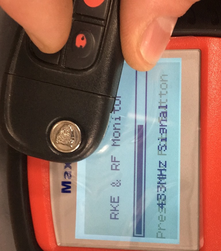

Try to find someone who has a test unit which can check if the radio functions of the keys are still working, maybe a shopping mall key-cut place or even a car audio shop.
This is the one I have
It can see if the keyfob is actually sending out the radio signal.
If the keys are still broadcasting, then the problem most likely lays in the KVM (Keyless Entry Module) in the car.
Attachment 207562
great idea. I've seen similar machines at home depot and walmart that can test the fob's signal for key cutting ( just wish that they could also get me a whole new programmed fob for $69 - lol )
