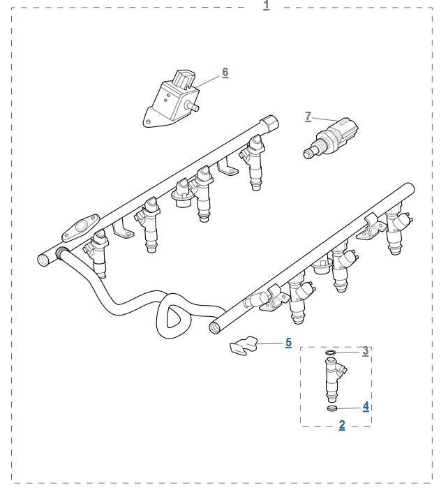

The fuel filter is located behind the left rear wheel in the wheel arch. Follow the lines up to where it is located. Attached is a picture of the fuel rack. The pressure port is the piece that looks like a cap. It is on the left side of the fuel rack.

Thank you for the quick reply, you pointed me in the correct direction.

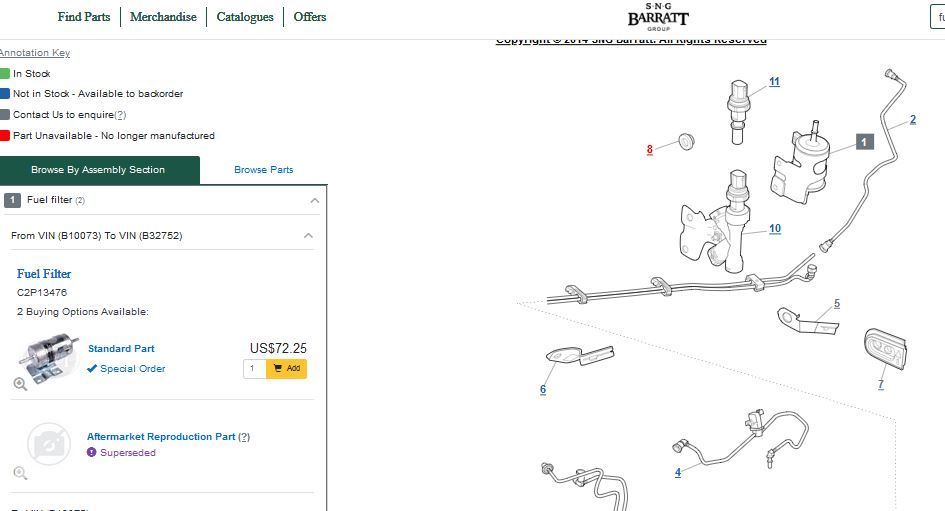

SNG Barratt thinks you might want to buy one. They stock them, same part # for all VINS up. The pump sock stops big stuff that can harm the pump.

Cars up to VIN B32752 are a 4.2 cars. B32753-up are a 5.0 ones and doesn't have a fuel filter, except for a sock on a pump.
