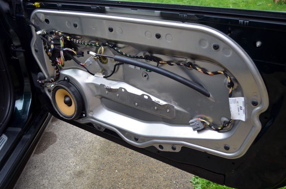

Also having a central locking problem, drivers door wont lock with key, has to be manually locked from passenger side, then use the key (although I haven't checked if i can still open the door or not, just assumed handle pressed in = manual lock). Im guessing its doing to be some part of the door lock module thats broken, is it worth popping the door card first, or should I just buy the module because its the likely culprit?

Throwing parts at a Jaguar is a very expensive method of troubleshooting.
I'd take the door card off first to determine if it's a mechanical (linkage) OR an electrical (module/latch) issue. The most common cause of locking issues is a failed microswitch in the latch.

I know, im being lazy and should just check it. But if it was a mechanical issue surely I wouldn't be able to open the door? Do the central locking and handle have separate linkages?

I know, im being lazy and should just check it. But if it was a mechanical issue surely I wouldn't be able to open the door? Do the central locking and handle have separate linkages? ......
If you're being lazy, you'll be horrified at the procedure to remove/refit the door latch. This is what it looks like behind the door card:
Have a look at my thread on replacing the outer handle and door reinforcement:
https://www.jaguarforums.com/forum/x...cement-210597/
The exterior and interior door handles are combined electrical/mechanical operation.
