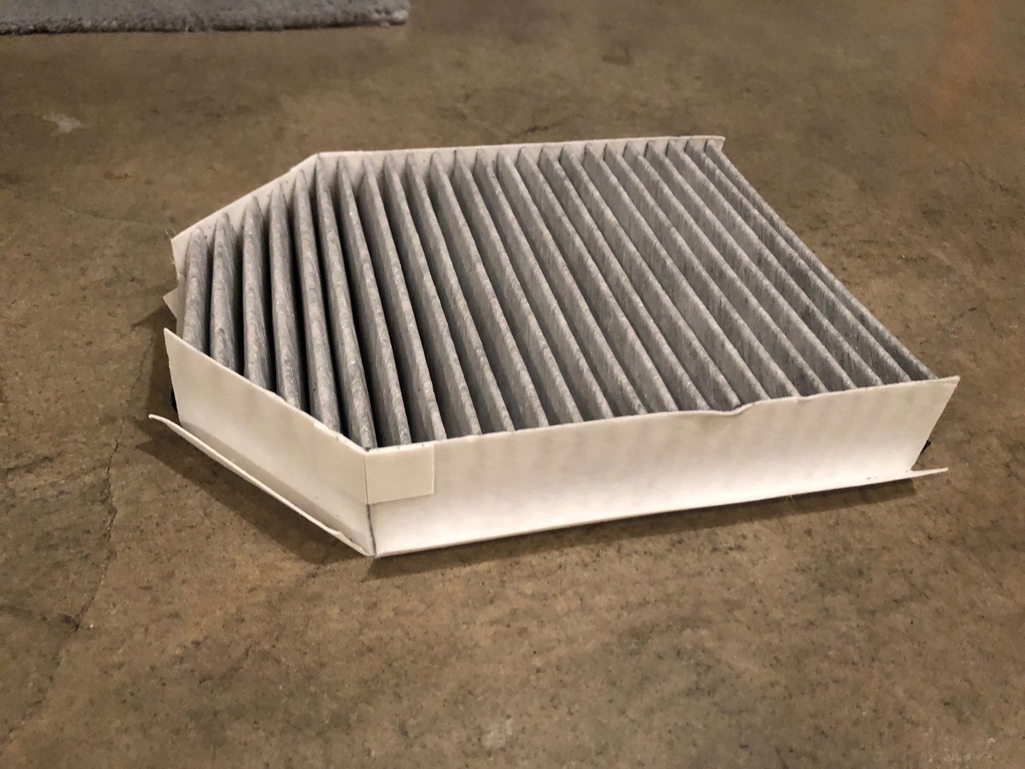

So I'm ready to swap out my cabin air filter again, and I'm remembering I wasn't confident the first time on one thing:
when I drop this in, does the side with the folded-over flaps face the front of the car, or back toward the firewall?

Look at the arrows I see in your photo.
I was confident I knew till I saw your photo, now I too am turned around.
Can you post a pic of that filter flipped over.

Here ya go.

The arrows are correct.
The second picture shows the intake side of it.

Right. So those arrows point back toward the firewall and not the front of the car, correct? I get the idea of the arrows but am not sure of the airflow direction there.

Thats right.
in other word, the flaps go towards the firewall.

The word AIR FLOW between the two directional arrows should remove any doubt. The air is being drawn IN to the vehicle, not OUT of it.

Airflow direction shows the intake side at the back of the arrow(Shaft side), and the exit side on the pointed end of the arrow.
Since this filter is pulling outside air in just place accordingly with the direction of flow. The air being drawn into the filter would go on the shaft side of the arrow, the filtered air would be on the pointed side of the arrow on filter.

Full disclosure: I was the person who installed the last one. It was aftermarket, had no arrows, and in the three minutes after I pulled the original one out I'd forgotten which way it went, so I just guessed.

It DOES matter. The outside face of the (OE) filter is covered in activated charcoal, the inside face is not. Reason for this is to deodourise air entering the vehicle.
