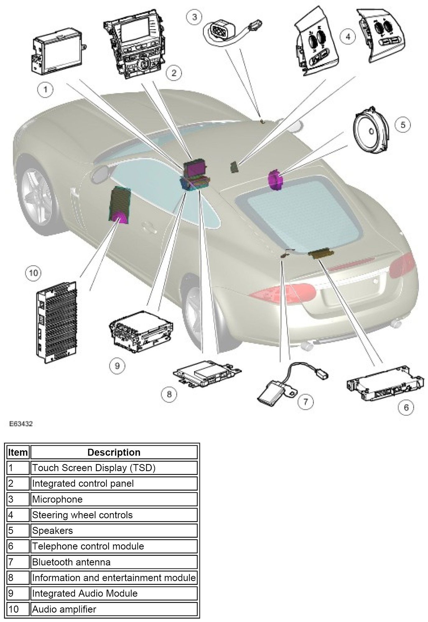

Download the workshop manual. There should be some illustrations in it.
https://www.jaguarforums.com/forum/x...guides-215509/
Here are a couple:
Not all of these apply to your problem. This pic is of a RH car so in your case, AMP is on the right not left. 1,2,6,8,9,10 are all in the fiber optic loop.

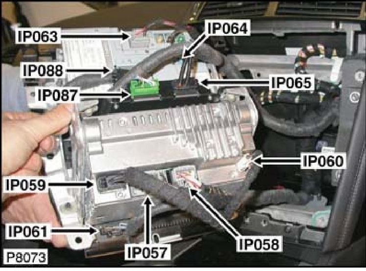

HEre is the back side of the Center console. IP059, IP065 and IP088 are the three Fiber optic connectors there.
