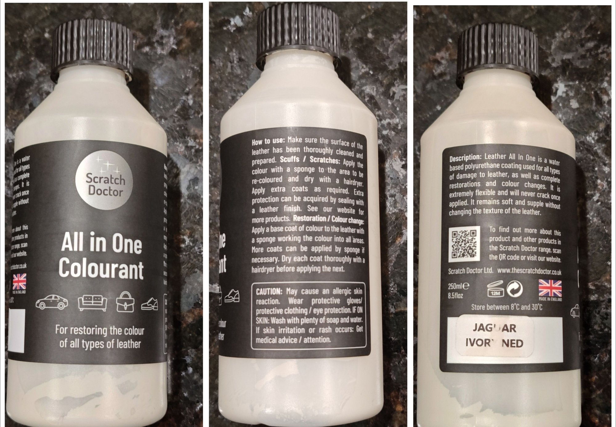

You may want to try re-dyeing your seats. Actually, they're not dyed - they're painted. Even if there are cracks in the leather and they look awful now, repainting them with the proper product that can fill those cracks will make a huge difference.
It's an easy, DIY process that can save you hundreds of $$$. All you need is to first clean your seat and let it dry, and then use a small sponge (included) to dab on the water-based colourant, and a hair dryer or air gun to thoroughly dry it before applying a second coat. IMHO, it's worth trying a small bottle and apply several thin coats on a bolster to see if it's acceptable. See this thread:
Recolor Ivory Leather Seats
The product mentioned in that thread is no longer available. This is what I recently used to touch up my driver's seat upper and lower bolsters (from the UK):
Scratch Doctor Colourant - Ivory (NED)

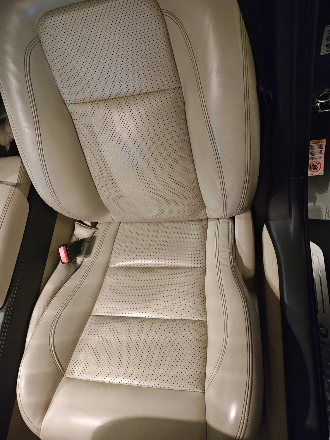

My driver's seat (after) - sorry for the shadow, shot in my garage.
Of course, you can order Black, the OEM Charcoal color, or anything else.
