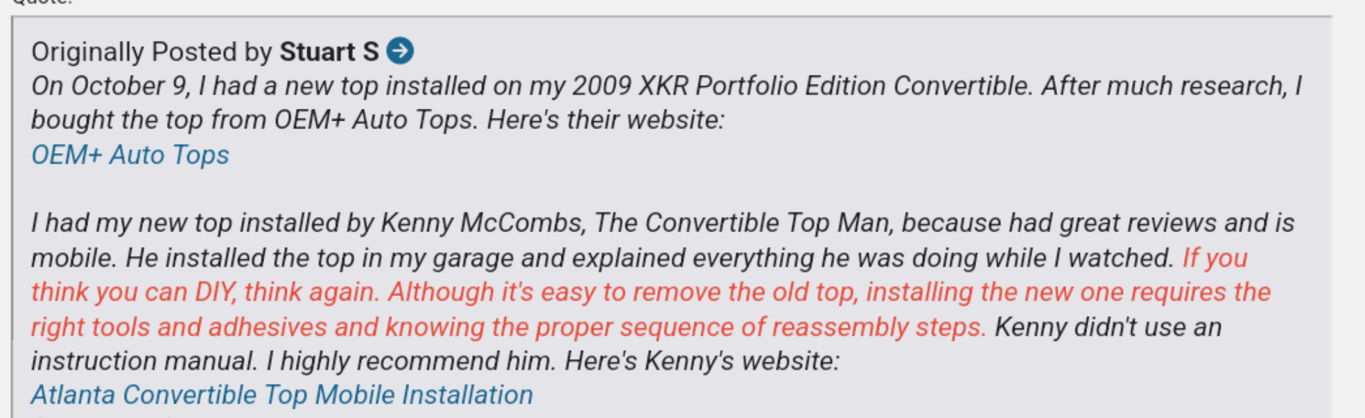

You can't say that I didn't warn you. From my Post #1 in this thread: New Convertible Top Installation
​​I hope you get everything sorted and are pleased with your new top.
