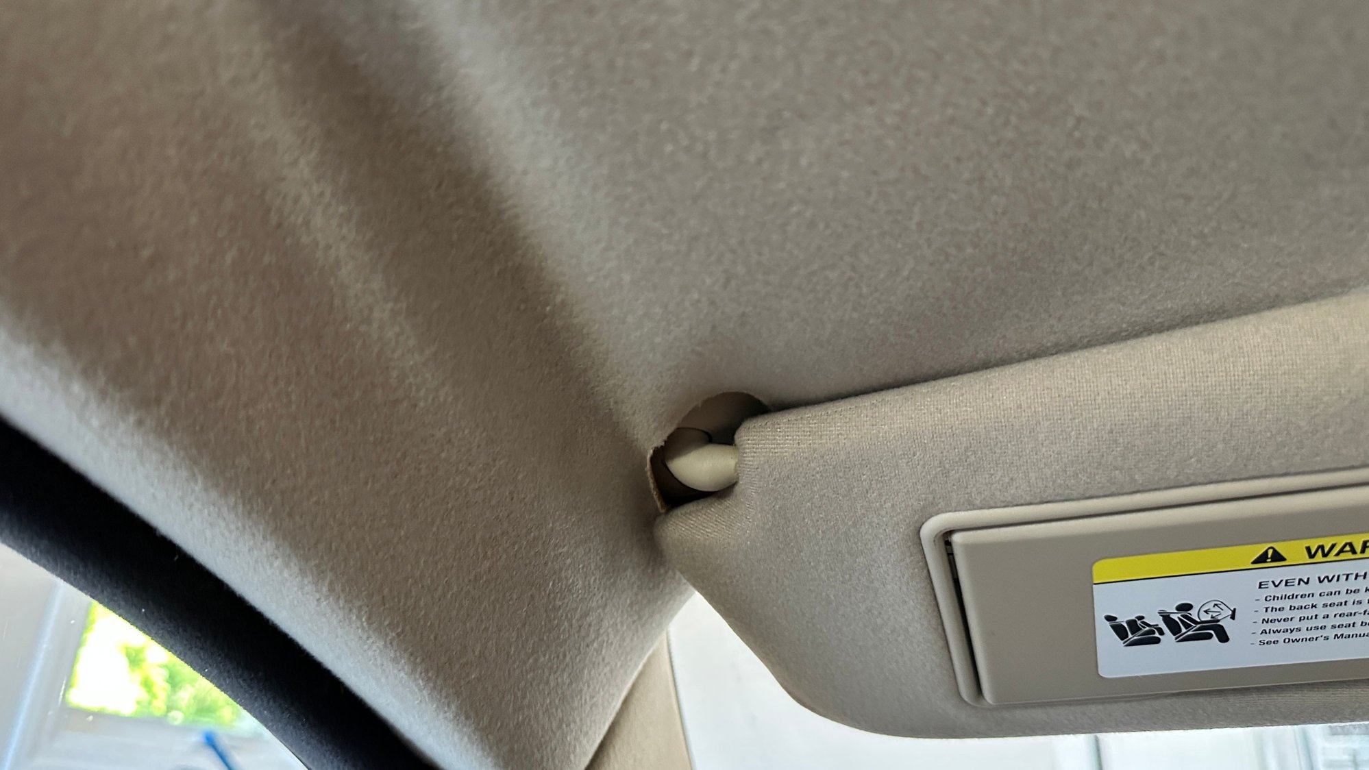

The car is running strong except for the front hood alarm sensor that has been fouled up with coolant after the nipple on the expansion tank broke off. Still waiting on my mechanic for a replacement. Engine light periodically comes on. He claimed it was a battery code, although battery was just replaced. Maybe I have to take it back to Costco. An Energizer AGM that I dropped $400+ on.

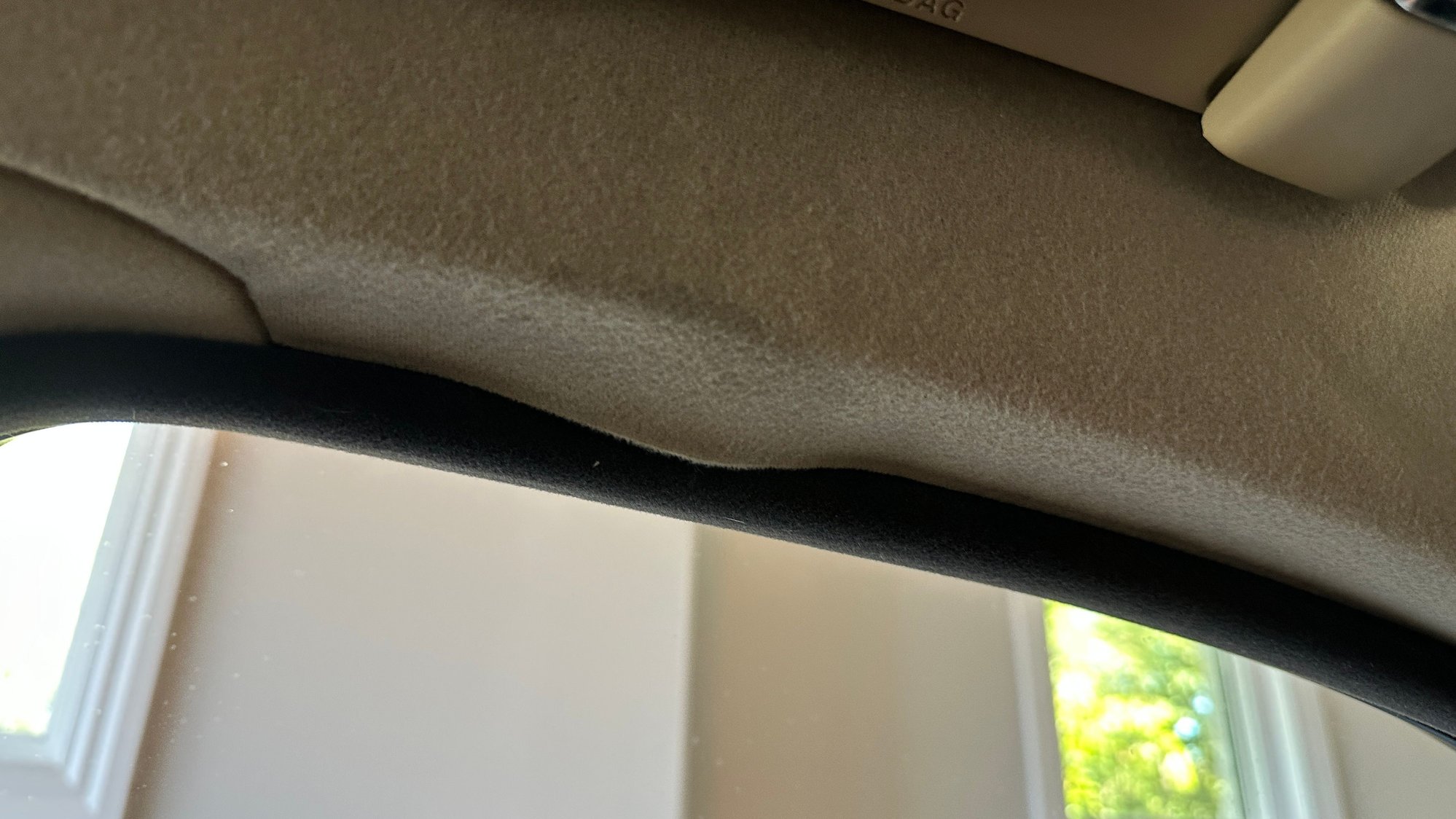

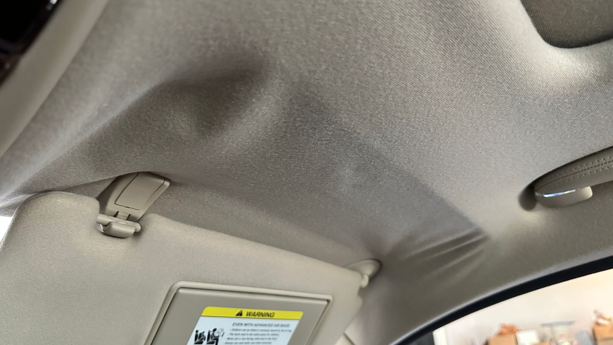

But overall, the headliner is not on my head but it is getting worse near the driver’s front door. I keep the front visor down most of the time and it was already loose underneath both visors. Then it started over that door after I attempted to clean some dirt (still visible in photo) from the last mechanic visit . Basically it’s loose in all four corners.
Noticed it coming loose around the visor mechanism.
I managed to shove some of it back in with a credit card but there’s virtually no excess to get under the weather strip.
Passenger visor.

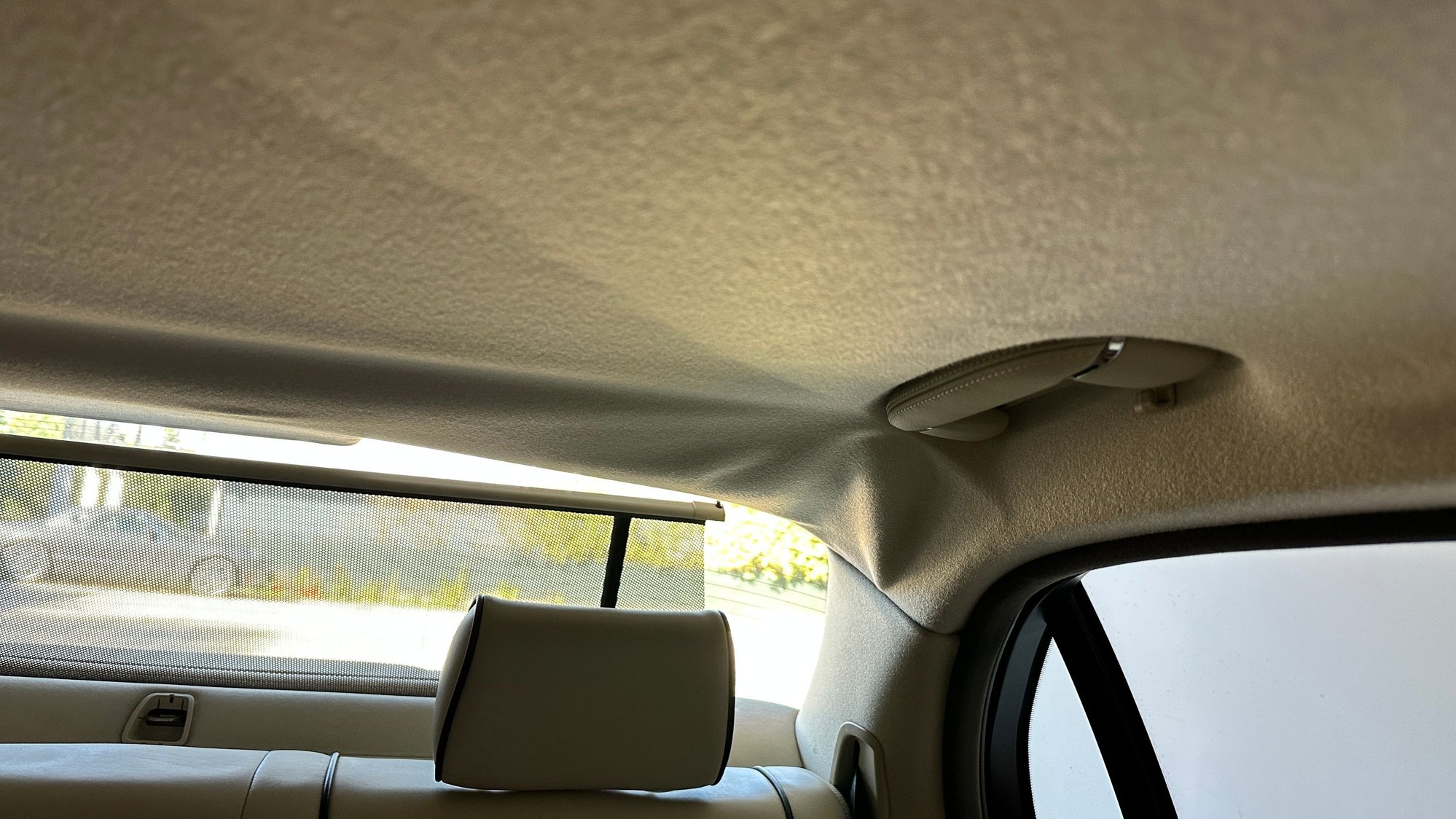

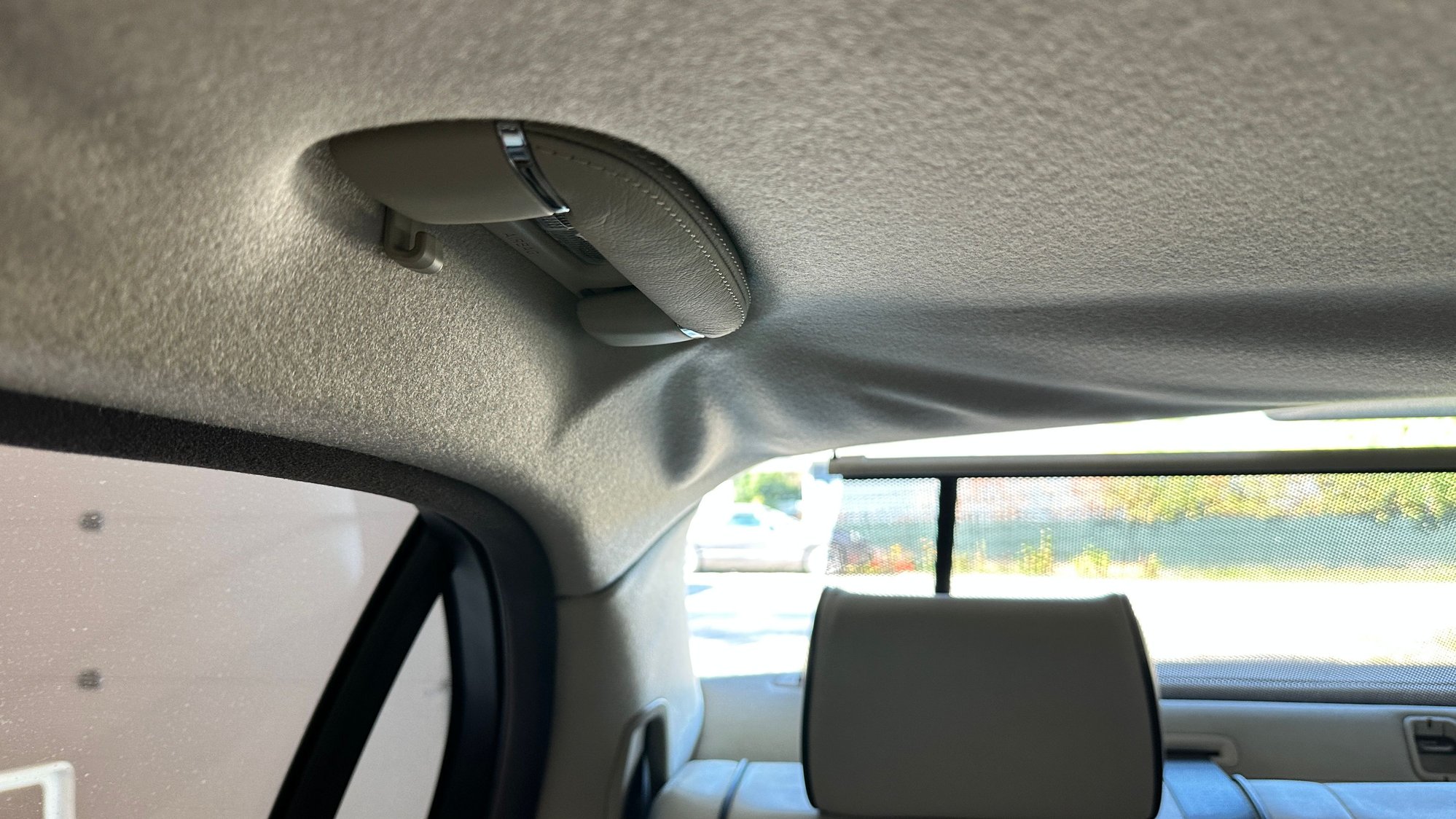

Rear passenger side.
Driver’s rear.
