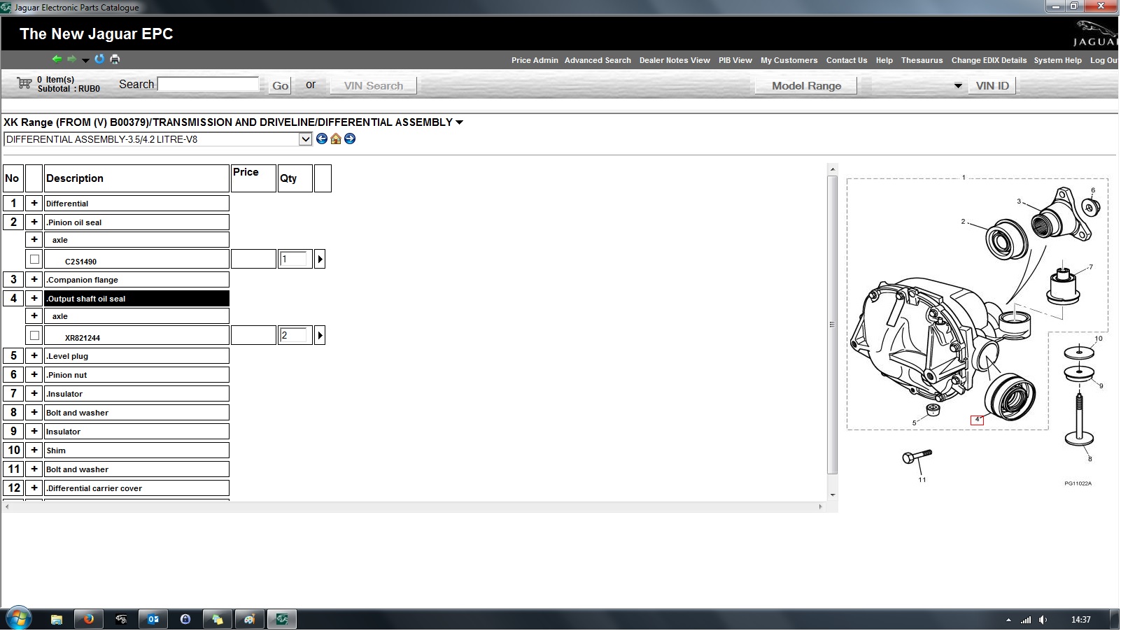

Old Apr 17, 2015 | 08:43 AM
Likes: 17,016
Originally Posted by ardifan
Friend has an 08 XK. Started with a drip from the right rear pumpkin seal. Had it replaced but still drips.
Been told by the dealer to replace the whole rear axle with a new one (!!!).....
The only reason to replace a leaking diff would be if the casing is cracked.
If a dealer diagnosed a leaking seal, replaced it and it subsequently leaked, he'd be pleased to do the job again and do it right just to quieten me down!
