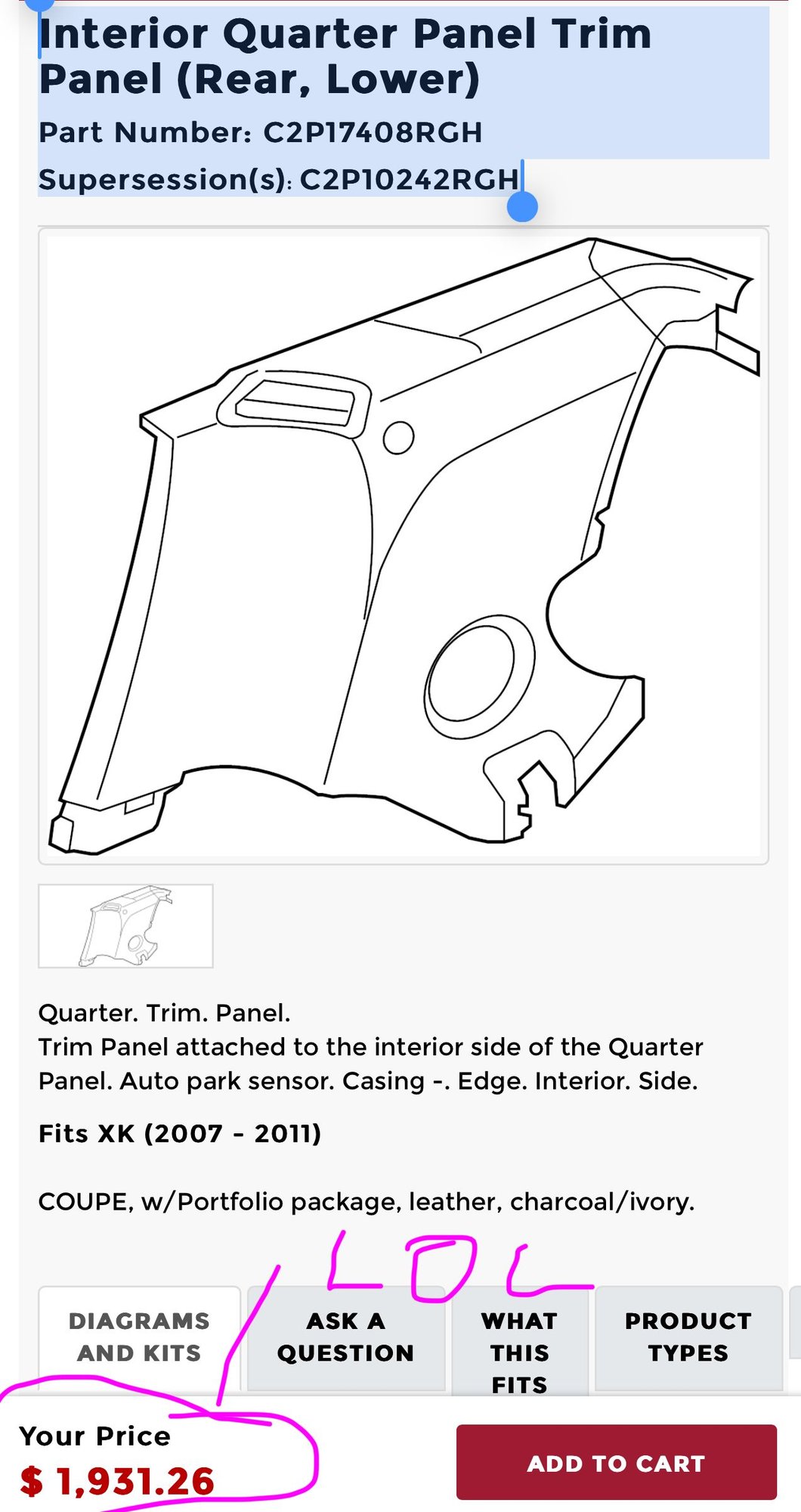

Anyone come up with a part number for this panel?
Edit: I found it.
Interior Quarter Panel Trim Panel (Rear, Lower)
Part Number: C2P17408RGH
Supersession(s): C2P10242RGH
Baaaahahahhaa $2k for new part.

I recently took mine apart to replace it as the seat had rubbed against it, not a difficult job to remove.
Check with these guys, they are usually pretty handy for parts or having unlinsted stock.
This is for a couple but you can still message them or call them.
https://www.ebay.com/itm/236174390703

@restd The damage is not unusual for Florida and Texas cars.
Part numbers are different for coupe and convertible. Part number may not help your search.
Use the OEM nomenclature: Interior quarter trim panel (rear lower).
Used panels should come with working sliding cover/doors or be discounted, dollars off.
If doors are missing: suspect damaged track. More discount if you want to disassemble and reuse your track.
Unless you are lucky enough to find a pristine replacement:
1. remove your quarter panels for inspection, and if good, repair.
2. locate black leather or leatherette suitable for repair.
Imitation is easy to find. The real thing may be salvaged from damaged XK, XF or other parts.
3. Carry the panels and material to a shop or do it yourself.
Keep us posted on your results.
