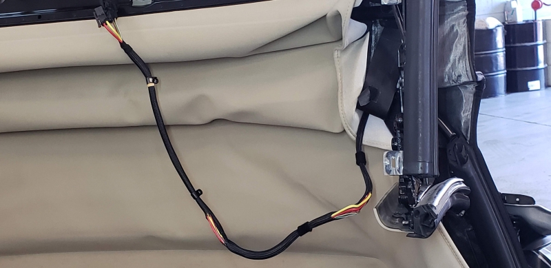

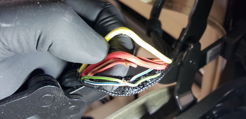

After taking the advice of everyone on this thread, I contacted white xkr and he took me through processes but to no avail....he suggested I take to the dealer. White xk has the patience of a saint and I appreciate all of the time he worked with me!
I took it to my local indy shop and low and behold, there were breaks in the convert top harness. The tech stated that he sees this frequently on aging cars!
Well $570 later, the top goes up and the windows follow as designed.

Hi John, just as a matter of interest, did your indie repair or replace that harness?

It was a repair...not a replace.
Looks like a relatively simple fix.....if you know where to look and how to actually perform the repair!
