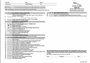

Hi all!
Above is a link to a pdf file with the maintenance check sheet for XK MY 2009.
Is this sheet available also for my model year 2011? Where can it be found?
And what about the work shop manual? Where can it be obtained or purchased?
Thank you!
ter

Perhaps the service manager is suggesting a transmission fluid change on your ten year old XK. Yes, published service interval for transmissions is much longer, but there is a good argument for changing transmission fluid at ten years when mileage is quite low. My '07 has but 41K miles, and am changing transmission fluid this week.
Old May 3, 2018 | 10:24 AM
Originally Posted by Ter11
..... Is this sheet available also for my model year 2011? Where can it be found?
A strange decision to resurrect a five year old thread to ask this question.
The 2010MY Maintenance Check Sheet applies:
The official WorkShop Manual is available through JLR TOPIx (chargeable by the hour, day or month). It is also available on DVD in PDF format from the usual suspects.
Attached Thumbnails Recommended Maintenence??-xk-maintenance-check-sheet.jpg
