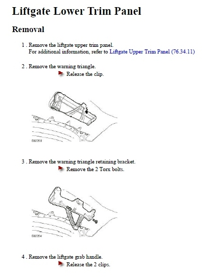

A Trim Tool, although not essential, is the best way to remove many interior fixing clips without damage to either trim or clip:
First remove the Upper Panel trim:
Then the Lower Trim Panel:
Not difficult but take care to avoid marking the surface of the trim when removing the fixings.
