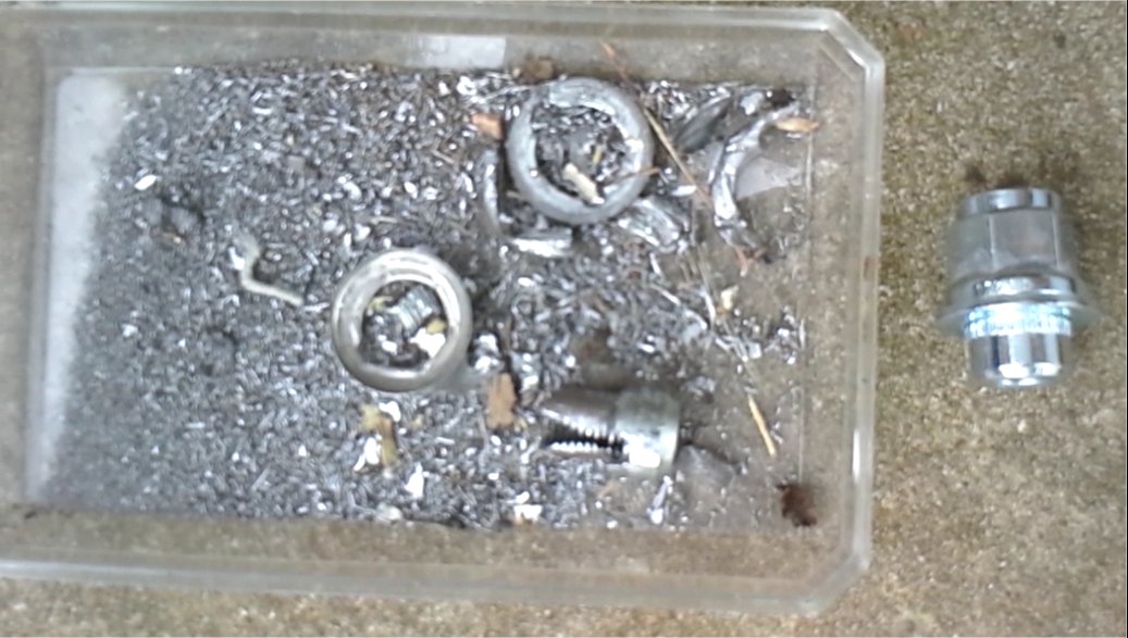

After being out of town for a few weeks, with my XK in the garage, the tire on my front right Senta wheel was flat (and low on tread) so I decided to fit the spare and get new fronts. Rash decision.
To sum up, after three hours work I have two nuts off, one cover still spinning on a nut (all the others did likewise) and two nuts showing with their covers now removed.
The two nuts will not budge. Flattened the edges of the correct-size regular 12-point socket so went to a six-sided snug-fit socket. The leverage/impact that I provided failed to move the nut but has broken the socket.
Now I'm in a quandary as to my next step:
Leverage appears to be useless.
Tried an impact driver with the original socket but that didn't gain any ground.
Have used liberal amounts of WD40 and am leaving overnight in the vain hope that this will help.
When the WD40 doesn't help, what have others tried?
I would use a blowtorch, or oxy-acetylene to heat the nuts (did this in the long-distant past, with steel wheels) but am concerned about potential damage to a painted alloy wheel.
Any other suggestions?
Didn't ever have this problem with the XK8 - was I just fortunate?

Thanks Brutal - wish your theory had worked for me Anyway, for all but one of the remaining nuts, hammering an 18mm socket over the nut enabled the cover to be twisted off. The 11/16" Craftsman Lug Nut Extractor then ate into and twisted off the nuts, again, all required about 200 ft lbs to remove.
The final nut? The cover would not release so used the extractor over the cover, time and time again with no unsticking occurring. Once the nut was reduced in size, a hole cutter, drills and chisel enabled me to remove it!! (See photo)
Alongside is one of the new Solid nuts - a perfect fit with larger head and sunk further into the wheel. Thanks so much to those who proffered these as a solution to the OEM disasters
