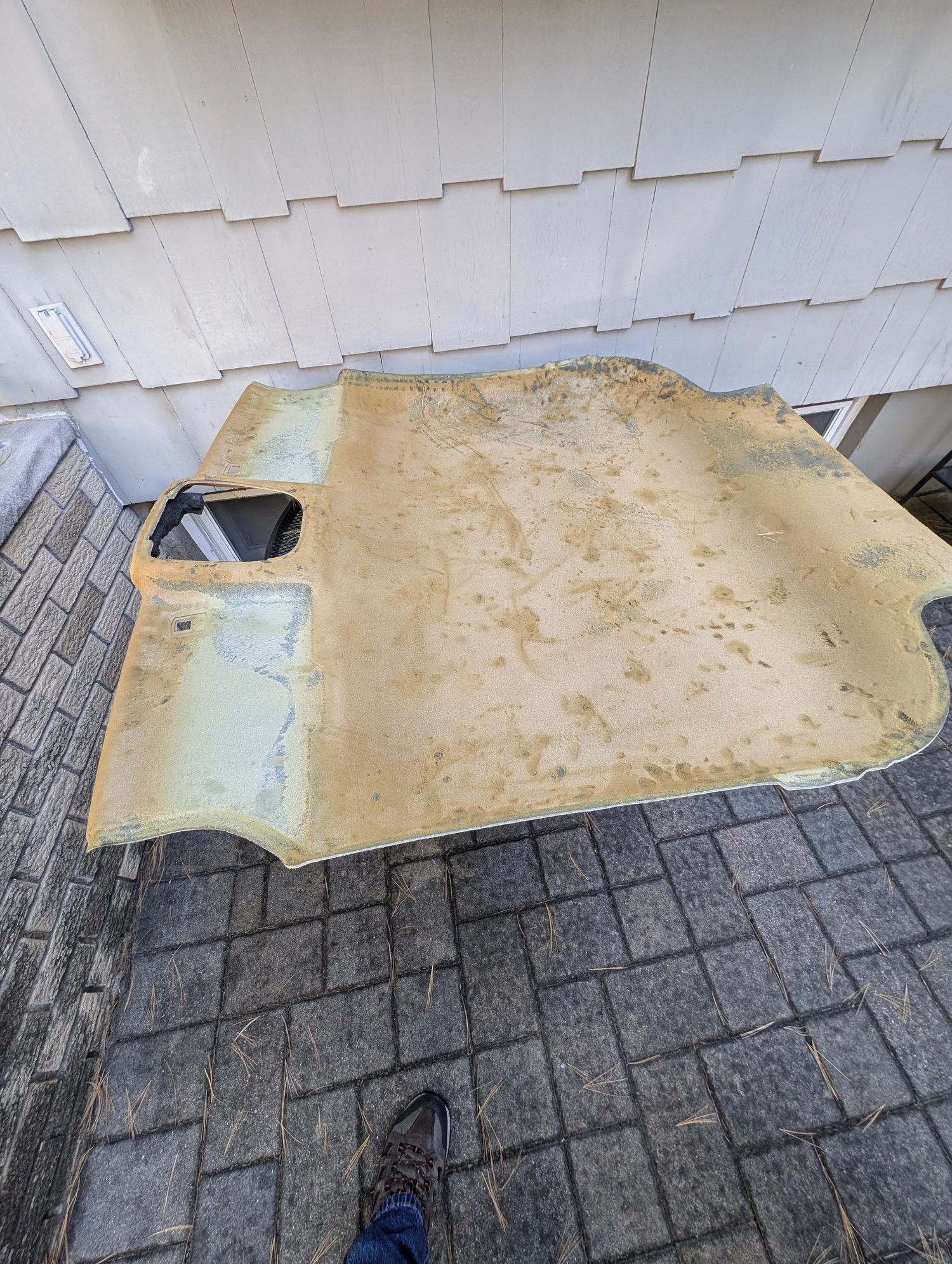

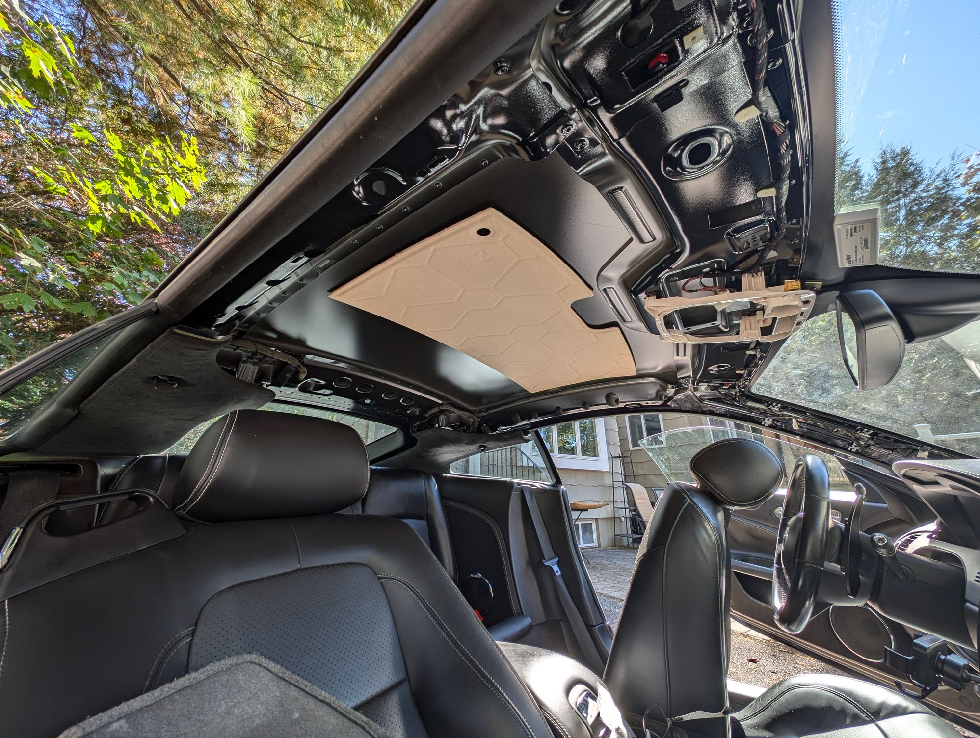

Hey Headliner Folks! I got my headliner out today and cleaned off the old foam. In the process, i managed to break 3 out of the 4 plastic clips on the passenger side A pillar trim piece. I can jb weld the parts back together, but for the life of me, I can't get the trim off... it seems stuck down at the dash level. Any tips on how to get it out to make the repair easier? The driver side came out fine... no clips broken, and easy to remove.
Old Oct 13, 2024 | 12:34 PM
  #117
SeanU's Avatar
Joined: Dec 2014
Posts: 296
Likes: 118
From: NJ
Default Headliner... almost done
Thanks for all of the earlier posts.
Fabric used : 1/8 Foam Backed Jet Black Synergy Faux Suede Headliner Fabric 60" Wide 4 yards from Fabric Empire Cost : $79
3m Headliner glue... I used about 1/2 of a can for the headliner. 1 can would cover a headliner and all of the trim if needed.
Notes from install :
  • As noted in previous post, i broke 3 plastic clips on passenger a-pillar trim which i still need to repair. Everything else came out ok... harder to remove than expected. The rear trim is left hanging and does not need to be fully removed
  • I used a plastic spackle/putty applicator from homedepot to scrape the bulk of the foam and glue off. The remaining glue layer is very tough, and took over an hour to remove. I tried wire brushes, sandpaper etc. I found duct tape looped around my fingers very helpful for cleaning the hard stuff up... it picks up all of the "glue *****".
  • I thought i would have more time to work with the fabric and glue, but the 3m glue sets very fast. I worked with the fabric folded back 1/2 way, doing the rear portion first.
  • The front portion has the trickiest part to get right... the overhead console "bump". My advice is work the fabric from the middle forward to where the hump starts, and when you get to the hump, work from the hump outward to the side edges. In my haste, i didn't work that area fast enough, and the fabric is slightly lifted where the base starts to curve up.
  • I used an x-acto knife to trim the outside edges... scissors won't get completely to the edge.
  • I only folded the fabric over the windshield front edge area... which is how the oem fabric was glued. Everywhere else is trimmed to the board edge as closely as possible.
I'll post some pictures after i get it back in.
Headliner Removed
Before foam removal
Fabric layout
Finished!
