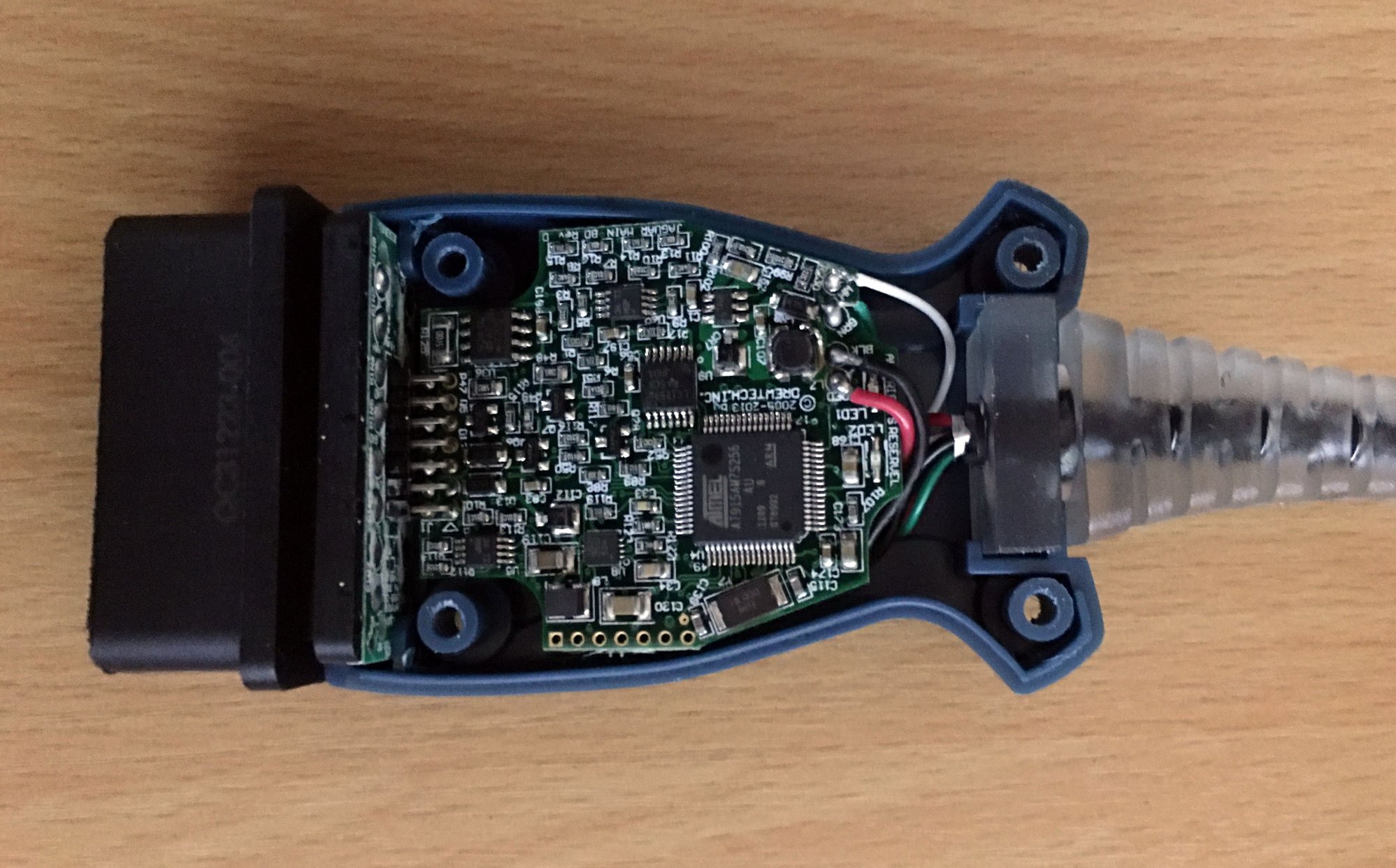

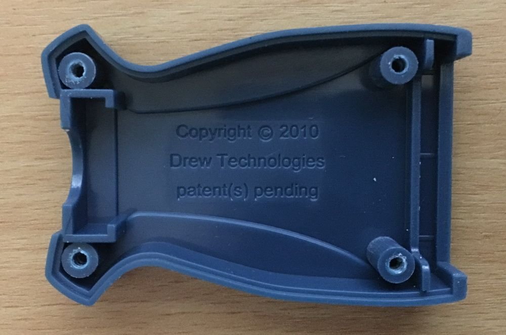

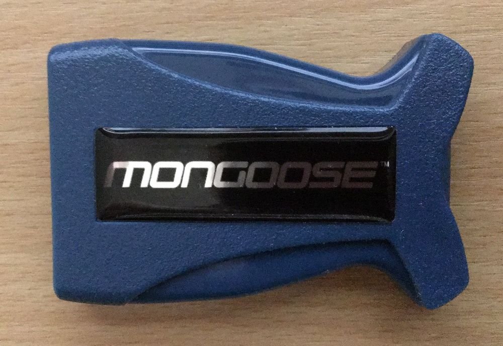

Old Jul 15, 2020 | 05:34 AM
Likes: 17,016
My clone Mongoose and Mongoose Pro are both very close to the appearance of the genuine Drew product.
The labelling is the same and so is the inside of the casing. This is the Mongoose but the Mongoose Pro clone is much the same:
The only definite differences between my clone and your genuine Drew are the clone has thinner cable, no sticker on the chip and no row of pins on the left of the board.
