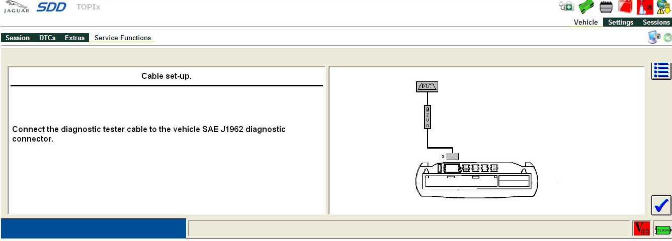

I'm trying to program additional keys with SDD using a mongoose clone. In SDD - Service Functions I see the programming options and have tried "Security - Program new transponders" When I run this option it goes through the prompts until it asks to connect the diagnostic tester.
I'm sure other members have been successful using a mongoose cable to program keys but I've been unable to find away around or ignore the "connect the diagnostic tester" Can anyone help?

Thanks for support & ideas. FYI - I've been running SDD v138 with a voltage maintainer delivering 13.7V but get still get the red battery symbol. Dont know why. SDD reads the vin automatically & I can get the service fuction menu and get DTC's. So i'm thinking SDD and monoose are communicating correctly. As a check I reinstalled v138 in a new VM and I'm still having "connect the
diagnostic tester" This prompt is for several of the service functions e.g. transponder programming, seat calibration, configure restraints module etc. Is anyone else getting this prompt?
For my last trial I swaped the battery maintainer for a battery charger and at the end of the session battery was at 12.86V. Still getting "connect the diagnostic tester" prompt. I tried disconnecting and reconnecting the mongoose but this didn't allow me to advance in transponder programming and it ultimately crashed SDD

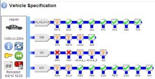

Does anybody know what voltage values change the battery symbol color in SDD - what's red, yellow or green? I'm connecting my voltage maintainer directly across the battery. Anyone see any issues with that? SDD reads VIN, loads vehicle spec page, service function & recommendatons. So could SDD or the monmgoose cable be the problem?
The SDD vehicle spec page shows the various module status. I have a couple of modules not responding, red X, could anything on the diagnostics be preventing me from accessing the transponder programming?

Voltage maintainer is not enough. Connect a good charger, able to output at least 20-30Amps of current.
Since you are running SDD in a VM, this way no security functions will work and every bit of programming is a risk. Install it on a physical machines to avoid problems.
