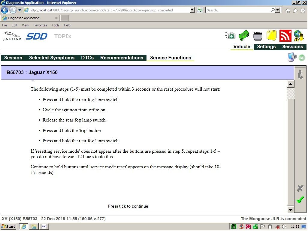

The Service Indicator isn't that advanced. It is a simple countdown against miles or time elapsed since the last reset. The reset procedure doesn't require an SDD session:
Normally reset at Service, an intermittent and unexpected warning message display can occur after running diagnostics - especially with a code clear.

Those above button pushes are quite finicky, and need to be done in a heartbeat rhythm to work. A steady beat and practice a couple times before attempting. Seriously.

When you do the reset procedure do not have the trip ometer displayed on the instrument cluster--you will not get the "service mode reset" confirmed messaged.
