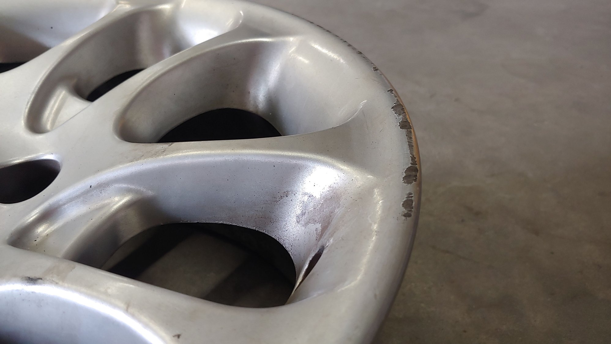

I tried the paint suggested by tarhealcracker. I have/had a couple of minor curb rashed areas that stood out because the paint was scraped off. The Dupli Color paint above worked great! The spray can (under $7) was cheaper than the same in a touch up bottle. I used a fine brush and applied several light coats....

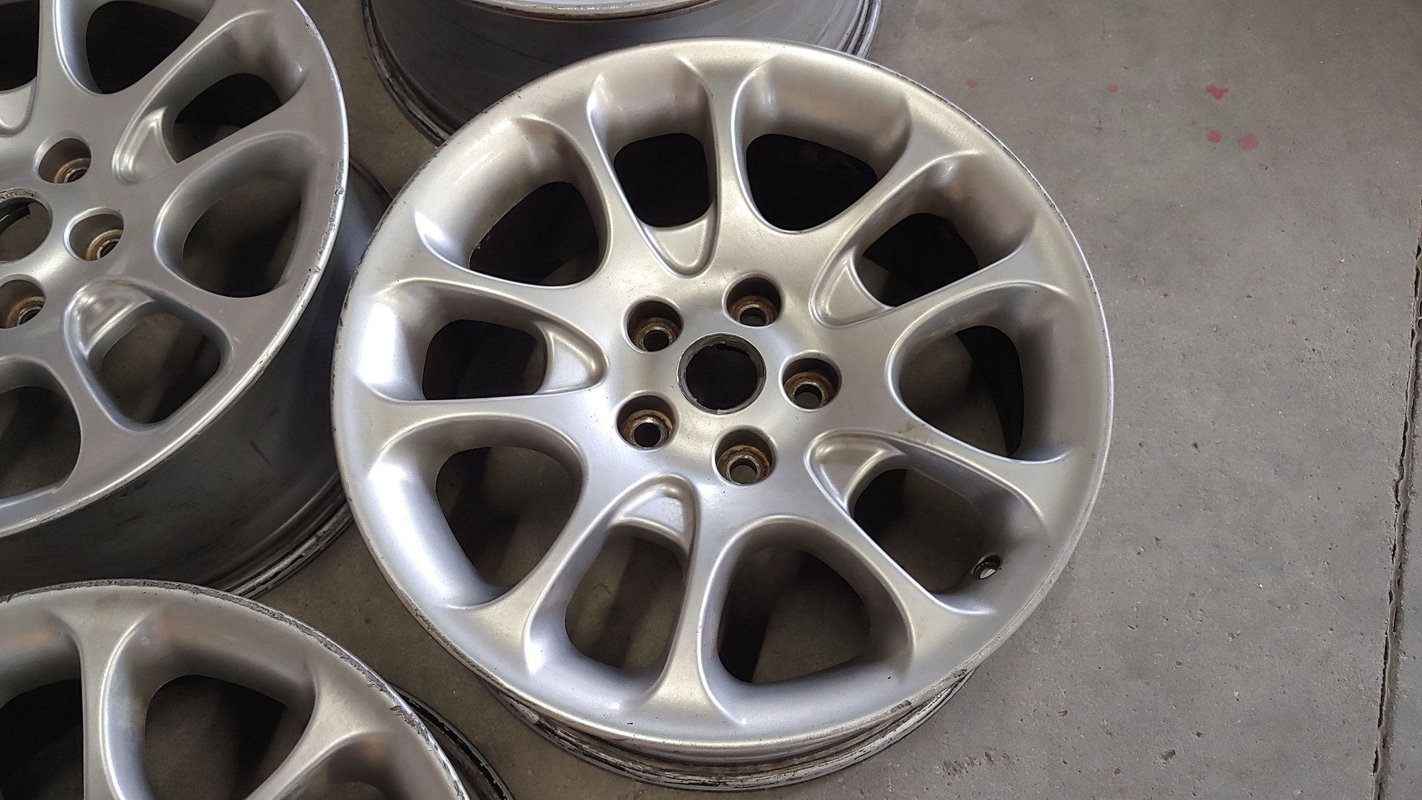

I have to repaint some areas on my Double Fives.
Any other member that tried that Dupli Color BGM0508 Ultra Silver Met (95 WA8867, 96 WA8867) since this has been posted?
These are my wheels now.

@Szabadi Kalman Your Public Profile shows that you have a 1998 XKR. You posted your inquiry in the X150 Forum, for the 2007-2015 aluminum models. Your XKR is the previous X100 model, and you should repost your inquiry here.
