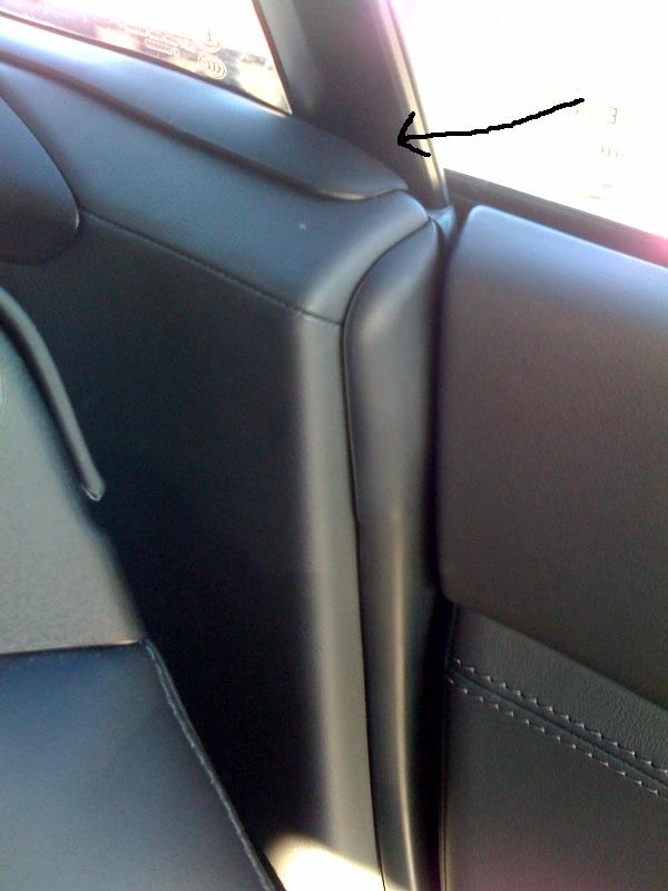

* * * UPDATE * * *
I fixed it... just a drop of household oil in between the two rubber pieces did the trick...see attached photo..

From: Oak Ridge, TN
jayduke, that's the area I was thinking about. Hope the oil stays on the leather to keep it from returning anytime soon.
